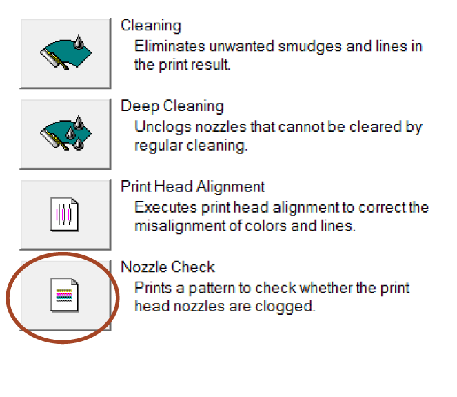

The nozzle check can be found on the Maintenance tab and should be run separate to all the other functions found inside this tab, the nozzle check does not clean anything it’s only designed to show if all of the nozzles are firing correctly, regular unnecessary cleaning cycles can be a hindrance rather than a help..
Nozzle.png click to enlarge.
