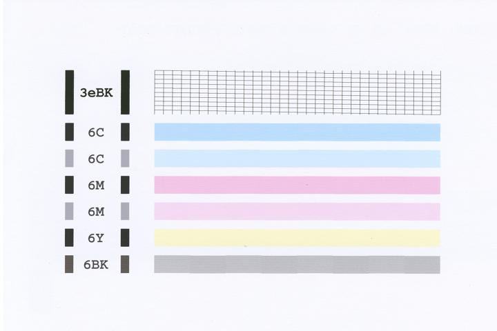

And here is what the MP760 Extended Nozzle Check looks like:

This is the standard Nozzle Check for the MP760:
