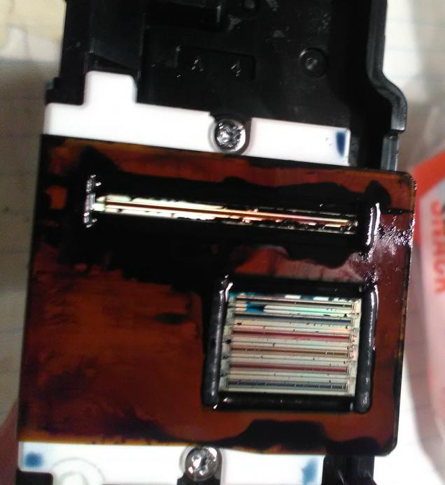

I cooked the original printhead by continuing greyscale printing onto plain paper while one of the colour tanks had run out yielding the "052 printhead not recognized" error. Like a lot of ignorant consumers who owned this high quality printer I had no understanding of the thermal printhead technology that Canon uses and kind of resented the high ink operating cost.
Ive subsequently bought 2 printheads from (not Chinese) Ebay sellers - one in foil described as "new" and the other described as used but tested as working.
The problem with both of these printheads is that there is nothing being printed from the printer (not even a nozzle test). The printer otherwise operates as normal without error messages. When I examine the printhead after trying to print a nozzle test there appears to be ink on the nozzles indicating perhaps that both logic board and printhead are working OK (?) I have no idea of the condition of the purge system though. The printer has sat idle for many months.
Could someone tell me if the problem might relate to the printheads, the purging / priming system or the logic board? Does the printhead need to be primed first to operate? Ive read here that air in the nozzles might prevent the flow of ink.

I cooked the original printhead which was a qy6-0067. The two other printheads Ive bought were a qy6-067 (from Hungary - appeared to have been pulled from a working printer as it was covered in ink) and a qy6-0075 (from Australia - described as new and in sealed foil package but would probably be refurbished).
There is nothing being printed including running a nozzle check.
I have replaced the OEM carts and still no nozzle check is printed.

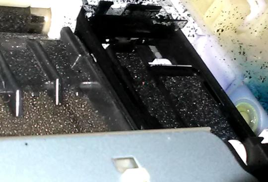

Ive saturated the purge pads with distilled water and then allowed the printhead to park. When inspected with the cover opened again the water had disappeared indicating that the purge unit is working.
I suppose that indicates a problem with the printhead or logic board right?
After the printhead has been primed there is ink both on the nozzle side and on the cart side of the printhead which I suppose confirms that the purge unit is not at fault. Ive attached photos.
So I suppose I have to replace the logic board to confirm that the problem is the printhead?

QY6-0067
The easy answer is yes. The more complete answer is it is either one or both.
If the print head failure was spontaneous, instead of gradual, then the odds are electrical failure. Where this failure initially occurred is unknown. There is also the rare possibility of an electrical failure in the print head can propagate to the logic assay board and vice versa. Usually, mostly, the print head is the culprit and replacing it gets you back to printing.
The issue is clouded by the question of functioning of the replacement print heads. It is unknown if they were working to begin with. Seems the odds would be that something would print, even if not from all the cartridges. But, we cannot be sure due to the provenance of the print heads, at least that I can surmise from the information you provided.
Let's say you replace your logic assay board, using any of the three print heads you have may cause an electrical malfunction in the replacement board. This is a very rare occurrence but has been reported.
Maybe another print head will work. Third time's the charm, right? Or you could be throwing good money after bad.
It may be time to buy a new printer.
