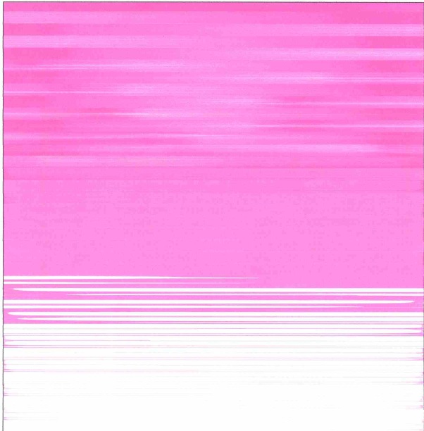

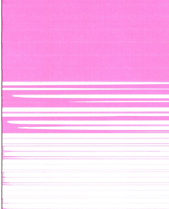

I succeeded in recreating the error. Printing 5 A4 B/W test photos didn't make the magenta cartridge fail, but a magenta purge page created in MS Word with a large rectangle with magenta fill color, RGB values 255-0-255 did the trick. The first page printed OK, the second produced this result, the first picture is reduced in size, the second cropped, click to enlarge:

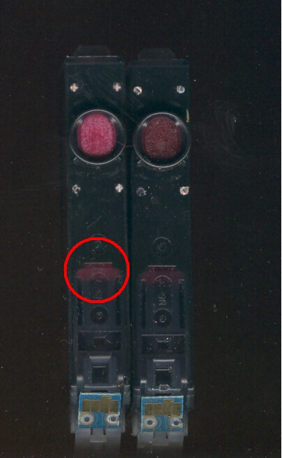

After the cartridge had failed I examined it and found that the outlet sponge and the encircled area were a lighter color than normal. Here is a scan of the failed cartridge and a normal one, click to enlarge :
The failed cartridge still held about 4mm or 5/32" of ink in the reservoir. I left it in a cartridge clip overnight, and checked it in the morning. It had not changed in appearance. I put it back in the cartridge clip for protection and tapped it hard against my desk, both with the ink outlet and the chip facing down. Suddenly the ink in the reservoir disappeared into the sponge and the ink outlet and the encircled area turned into the normal darker color within a minute or less.
I must say stratman was perfectly right about the ink starvation and that my previous tests had not stressed the cartridge enough. Also ThrillaMozilla's suggestion to tap the cartridge worked perfectly. I don't think the vent was clogged. Holding the cartridge over the kitchen sink, after having tapped it, and blowing into the vent caused ink to exit from the outlet in a normal manner. I also think the sponges were in no need for reconditioning.
I think the cause of the problem was either that the sponges had been shifted in position by my poking with a needle or that I had failed to maintain pressure on the SquEasyFill bottle when withdrawing the needle, causing an air lock.

PeterBJ, I think you just gave us an excellent diagnostic tool. If the exit port is light in color, that means that ink is not getting out of the cartridge. If it's dark in color, that probably means that the print head is clogged.

A very good point ThrillaMozilla but only if you have two the same cartridges to compare with.

After flushing and drying the cartridge, I have tried poking around in the sponge using a blunt needle, and watching what little can be can be seen of the sponges through the transparent end wall. The sponges appear to be firmly wedged in the cartridges, so they do not appear to shift position easily. That makes an air lock the most probable cause of the malfunction. I agree it is then the best thing to tap the cartridge with the ink reservoir facing up.

I also think clogged nozzles causes a regular banding pattern, not varying as the ink starvation caused.
