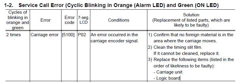

I searched for a service manual for the MP470 but found none. The error code 5100 is common for many Canon printers, here is a clip from a service manual for another printer, click to enlarge:
The "timing slit film" is also known as "timing strip". It is a transparent band with fine markings that are read by an optical sensor in the ink cartridge carriage. First check that the strip is properly placed, then wipe it with a soft tissue paper wetted with a window cleaner. Be careful not to tear the strip or the spring holding it.

Thanks for looking into. I did too and caught that possible solution but it didn't work. Mind you I didn't really get at it as it's deep in there. I'll try again later and maybe see if it's easy enough to open it up....
