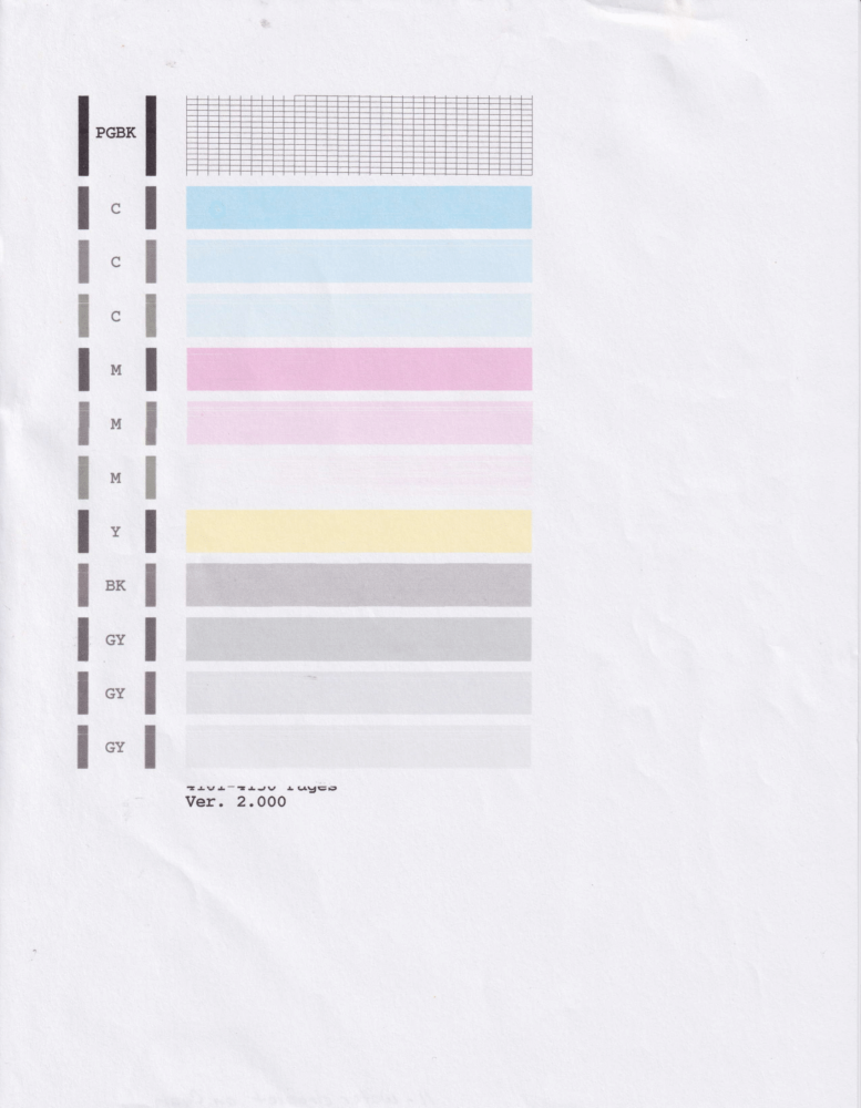

Thanks (again) for all input. I apologize for the delayed response/update. Based on cost, desired features, and user reviews, we purchased the TS8220. In comparison to its predecessor, my mom feels this printer is not made as well. Nevertheless, as a last resort, I tested the purge unit at the end of Summer 2019, per advice on other posts from users such as @ghwellsjr and @turbguy. Utilizing the latter’s instructions, if I remember correctly, there may have been residual fluid after step 2. Yet, this was the resulting nozzle check pattern:

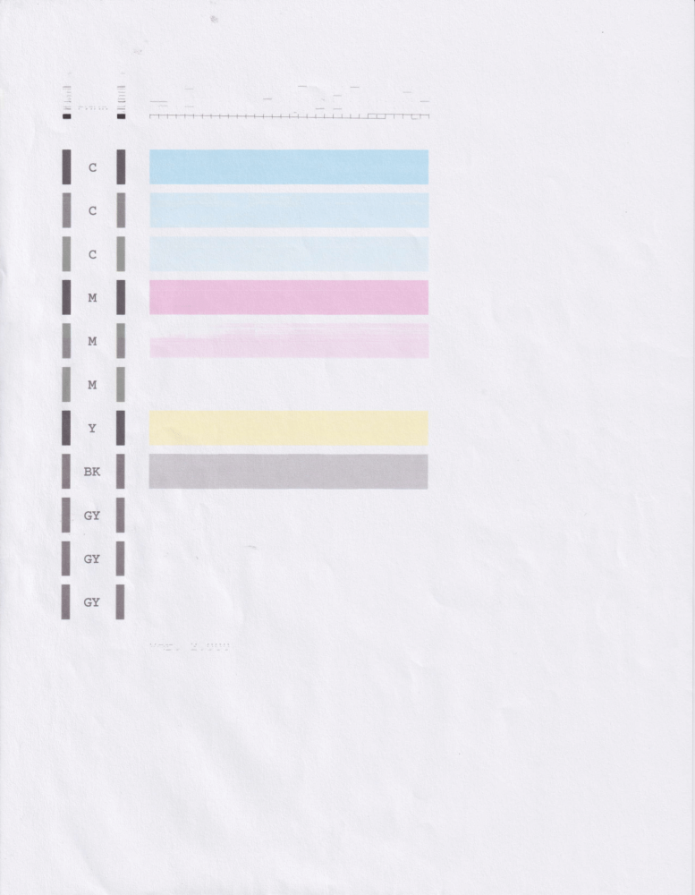

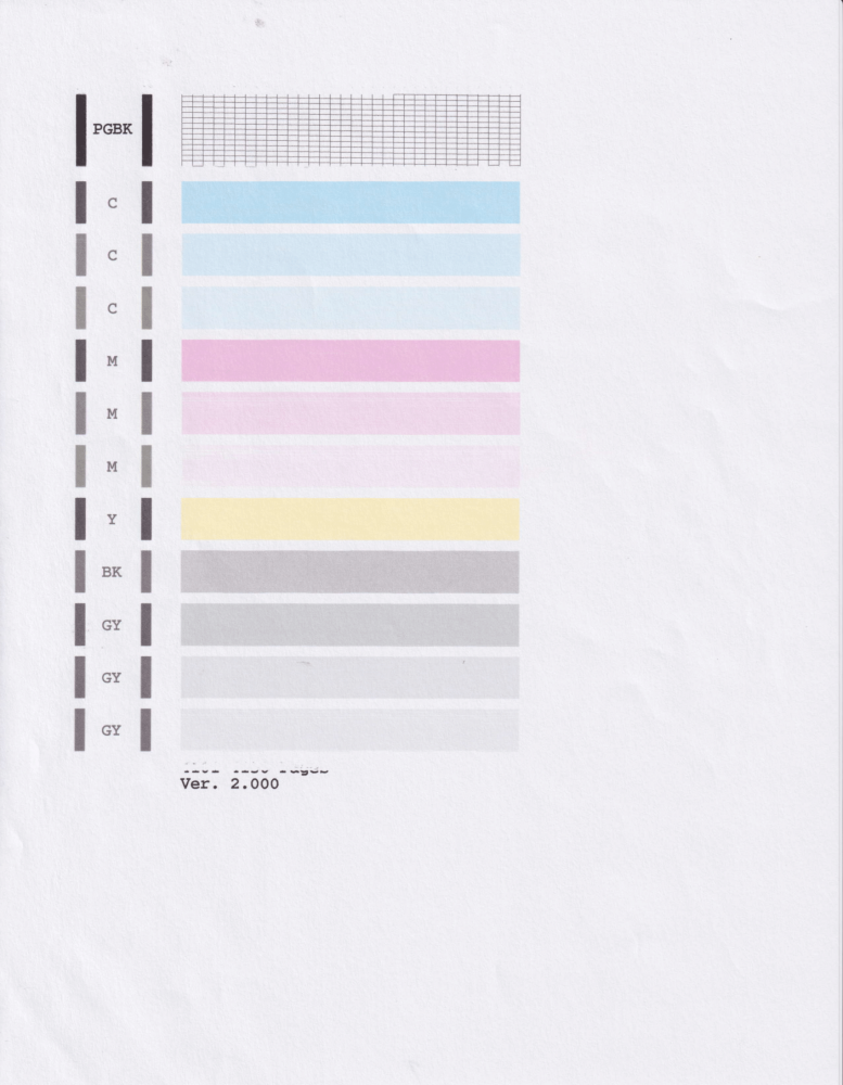

Obviously, while not all colors were present and PBGK was severely distorted, I considered this a success and crossed my fingers for further progress. Additional Windex cleanings resurrected the missing colors, several lines of the PBGK, and partial text at the bottom. I think I attempted roughly ten rounds of Windex, each followed by a nozzle check pattern, before giving up for the night. Below are the most recent tests (please disregard the water droplet on the top cyan bar and the dark marks on the second gray bar):

Good job getting the printer to function near normal. :thumbsup
From the looks of it, If there was a purge system issue then there isn't one anymore.
The missing nozzles of the Pigment Black ink lattice nozzle check are either clogs or burned out nozzles. You've been able to get ink flowing through some of the nozzles, so, chances are you may get all the nozzles flowing again over time and use.
The Magenta issues seem to at least be ink starvation (nozzle check #7 has much of the light Magenta but nozzle check #9 has little). A new Magenta cartridge, or a good flush and refill, should resolve this On Again - Off Again situation.
There may also be a touch of clogged or burned out nozzles as noted by the straight horizontal band of clearing in the upper third of the 2nd Magenta swath. This same horizontal banding can be seen in a Cyan swath. If this is true burned out nozzles then nothing will bring it back. In both the 1st swath of Cyan and Magenta there is no perception of missing ink to me, so maybe "standard" and/or "high" intensity ink setting will not show these missing inks. If this horizontal banding is a clog, then it may be reversible over time and use, just like the Pigment Black missing nozzles.
For more than one reason, the forum advice is usually to use a new or known working cartridge when issues like this occur. You want to take out the potential of the cartridge/sponge as the problem and first see if it is a print head problem and whether reversible or not.
You've come a long way to resolving your issues. Keep it up and you may have complete - or "good enough" - success.
