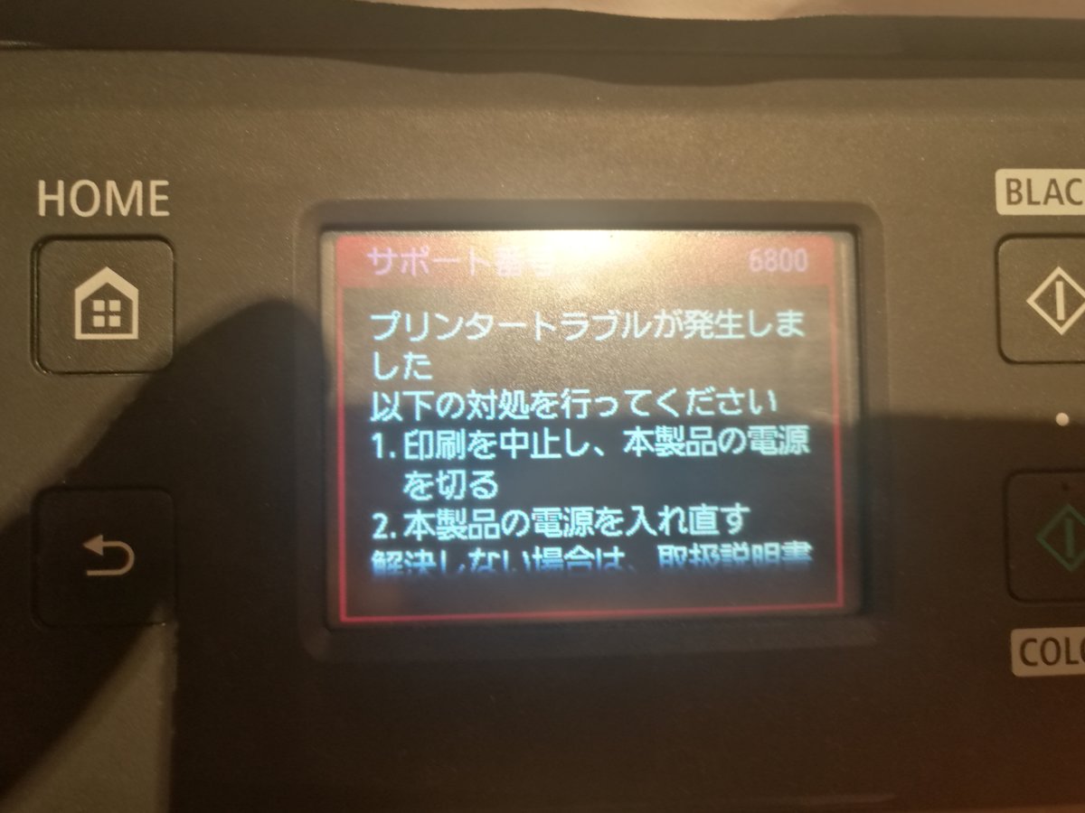

I have a Canon Mb5040 that has an error. There is writing on LCD screen that says 6800 and.....Japanese writing. Any idea what the error is?

Hi @Ali, can you give some sum more information about your Maxify, what happen and when, and how many LED flashing lights are showing...

yes LED flashing lights showing

The service manuals for the Maxify series of printers are nowhere to be found, but service manuals for other Canon printers list error 6800 as "EEPROM error" with the suggested repair "Part replacement: Replace the logic board ass'y."
Sadly I think the cost of having the logic board replaced by a Canon service centre will exceed the cost of a new printer, meaning the printer from an economical point of view is a total loss. But you could ask about the price before ordering the repair.
