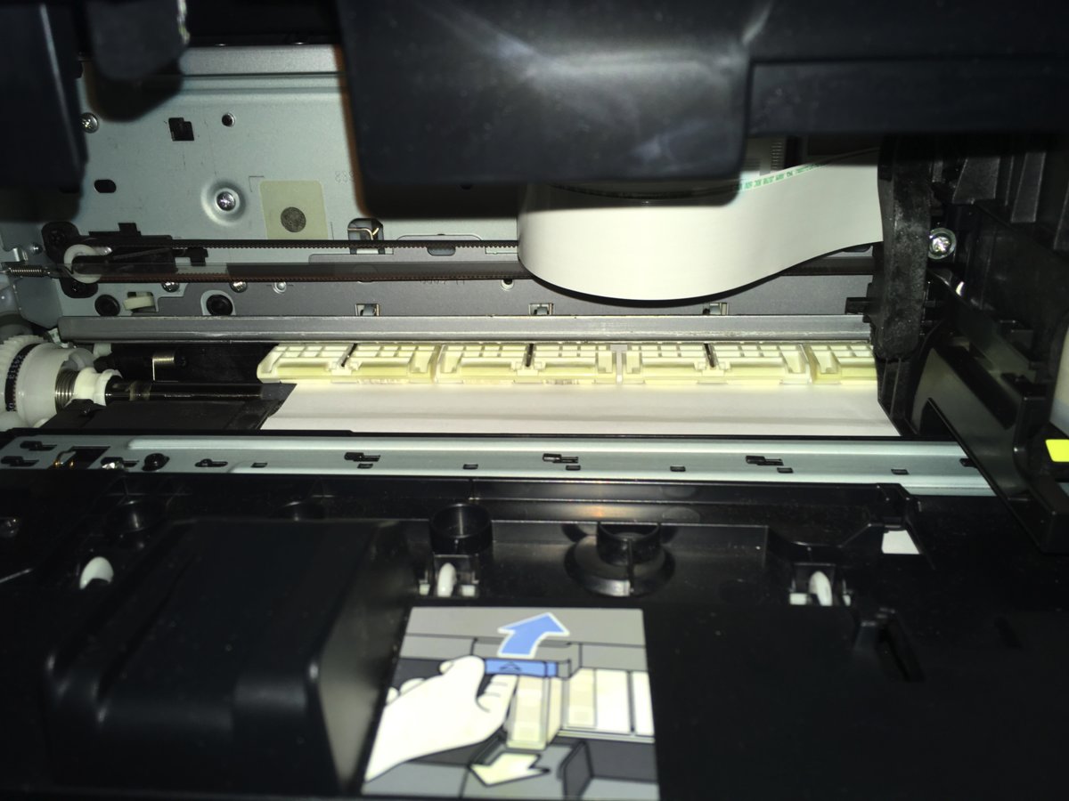

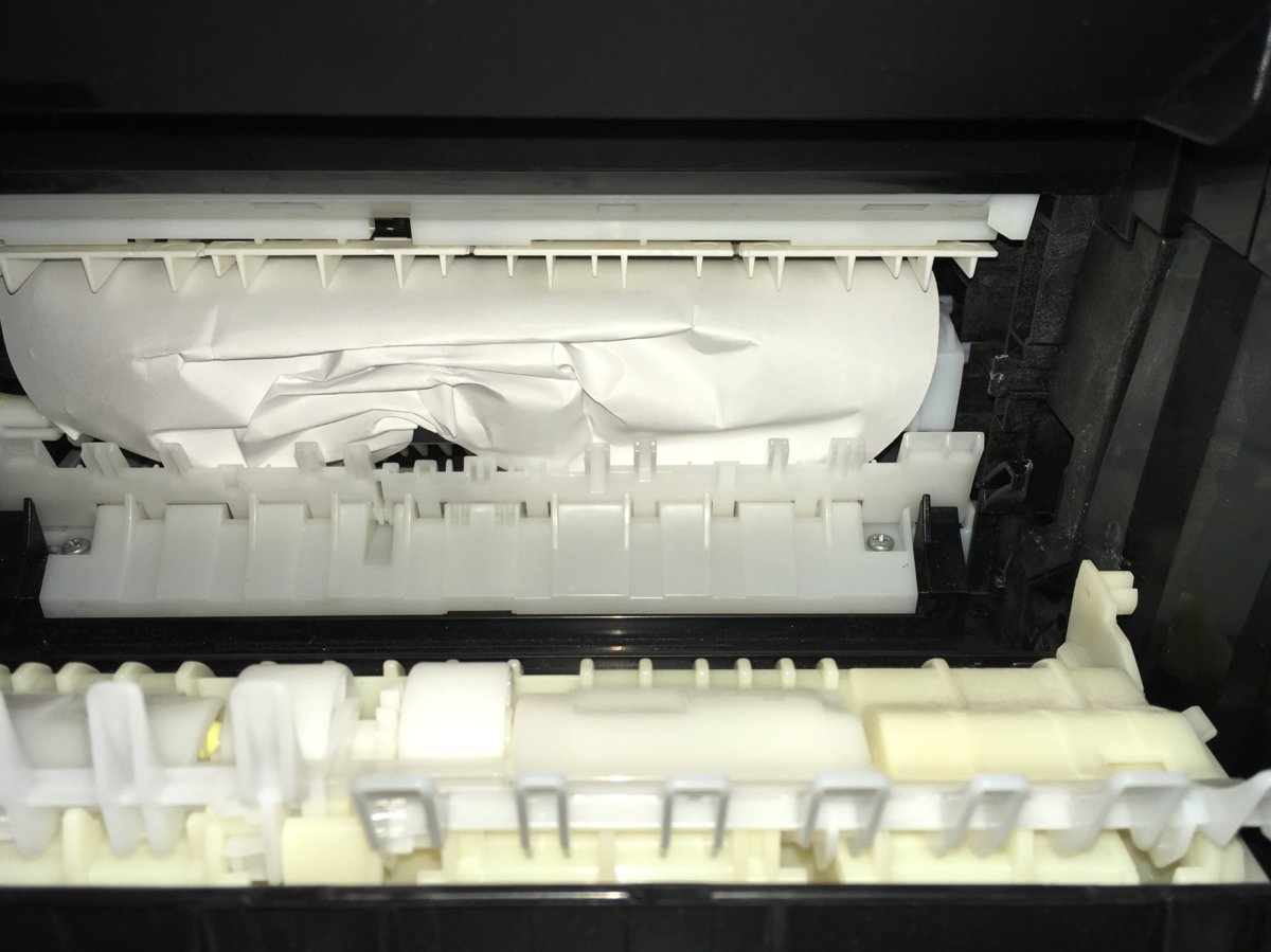

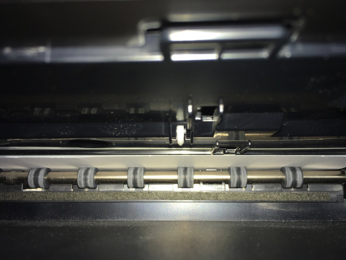

Actually, a correction on the "jumpstart" method I mentioned: the paper does move out into the output tray just a bit (about a cm or something), but if I power the printer again, it won't move from there - However, the back of the printer is trying to push the paper forward anyway, and it starts to crumble back in the duplex area. Here's some photos of this:
- paper being pushed in the back of the printer
- paper inside the printer (notice the crease that appears here)
- paper edge appearing in the output tray (won't move any further).

One additional thing I tried was feeding the page through the back of the printer, with the duplex door open (i.e. skipping the initial drawer feed). In this scenario the sheet would still just move a bit every time I powered on the printer, but there were no creases and the sheet eventually (after 10 to 15 cycles) exited the printer entirely.
In every single one of these cases I've been describing the printer stops at the 5102 error (observing the same behaviour as portrayed in the original post's video):
