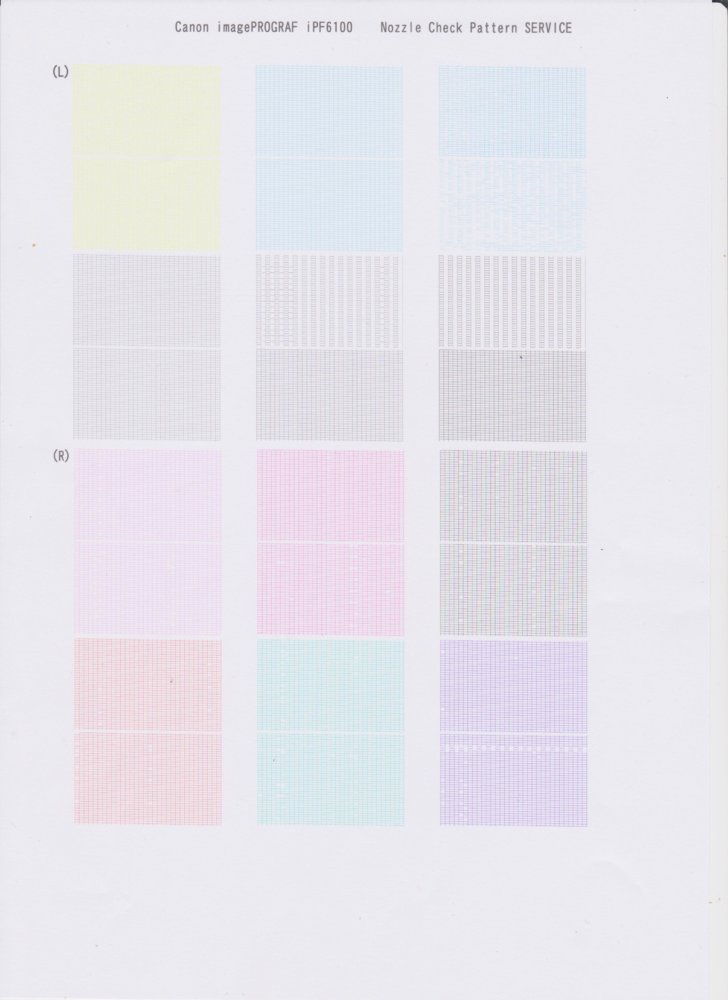

Thank you very much for your reply I am trying to figure out how to remove the Head management sensor the nozzle check attached here is the bad one
Looks like it might be a combination of electrical malfunction (eg the entire vertical loss of ink in the Black section) along with specific nozzle clogs (random loss of hatch or hash marks, each representing a nozzle).
Take this with a grain of salt since I do not understand what the repetition of the nozzle checks mean, such as testing different nozzles of the same color or ability to alter the intensity of the color printer.
