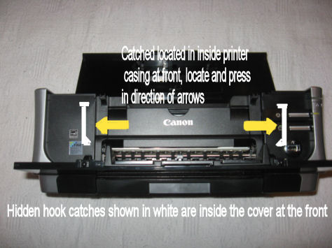

Here are the locations and method to release the catches, I know a lot of forum members will already know this, so this is for those who dont know where these things are located, including the front catches that are hidden behind the front part of the case, to the right and left, inside the printer head section for want of a better description. there can be located by placing your fingers inside the front casing and feeling for the catches, they will move outwards when pressed. Be careful when removing the top casing as it may catch on the print carriage if you have moved the print head to the centre service position.
The side plate catches are in two pairs, one of each pair is under the printer top lid at the front, the second of each pair are located under a pair of plastic blanking plates, each of these plates has a key slot on the side facing the centre of the printer, use a flat tool slid in to these slots and gently raise the blank plate up, just enough so it can be slid towards the centre of the printer, its fitted on slotted keys so it will slide off easily.
The side plates on the 4500 have a keyed guide underneath its lower edge, this must mate with the protrusions on the lower case when they are replaced, there are also two small plastic pins on the lower case at the front that must match to the front part of the side plate, these can be seen from underneath.

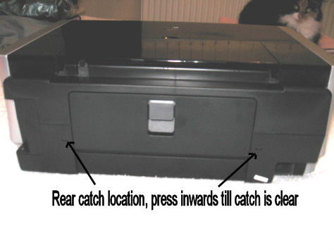

The two rear release catches are easy to find. Before removing the covers, remove the power module thats located under the printer, its held in with two catches, the power cable attached to the power module is not very long and is a little tricky to unplug. it is keyed so can only go in one way.
