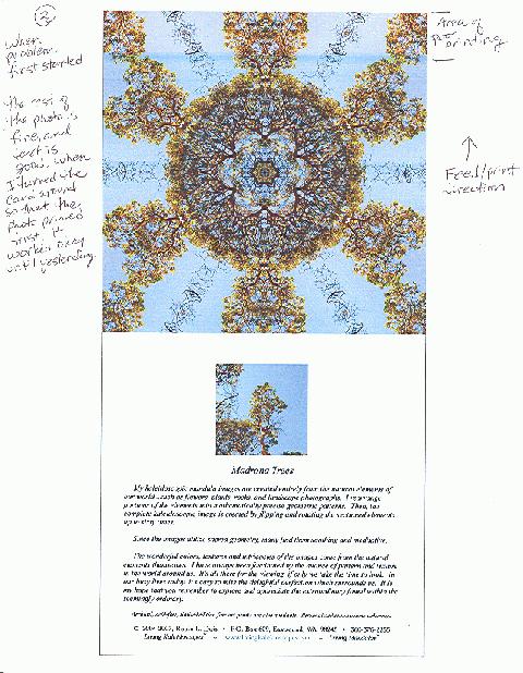

I use a Canon i560 mainly to print greeting cards of my artwork. I print a 5" x 10" card centered on an 8.5" x 11" page. It consists of a photographic image on the front half and mostly text on the back half. I use refilled carts with Image Specialists ink, and print using the high quality setting on matte photographic paper. I've had the printer for about 1.5 years.
A couple weeks ago, I began getting "banding" - I use quotes because it wasn't exactly banding, but I'd get a lessening of print quality on the last 1-2 inches of the image. It would only happen on the photographic image, and not on the text or spot color items on the page. I initally had my cards laid out such that the text printed first, and the image last until I had this problem. When I tried to turn the layout around so that the image printed first, and the text last, it worked again with no problems in output.

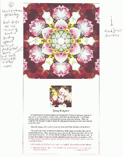

Scan 2.jpg - This is when I first noticed a problem. The print fed from the text towards the photo, and the last inch or so of the photo lessened in quality. The rest of the photo was fine as well as the text. I turned the graphic around in my program so that the photo would print first, and all was well (the text printed fine at the last inch), or so I thought until yesterday. I'm sorry that I don't have a copy of a print at this stage, but I've sold them. :)

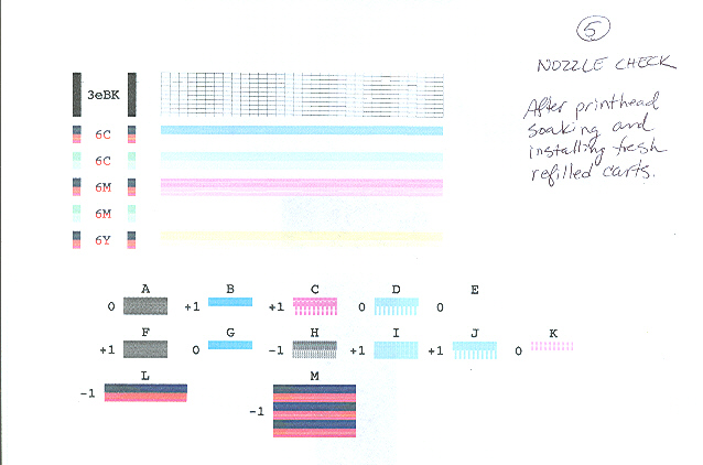

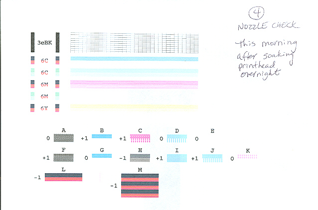

Scan 4.jpg - Nozzle check this morning after soaking printhead overnight in Windex with ammonia. I now have a red tint on the bottom halves of the black vertical bars surrounding 6C, 6M, and 6Y, and have a weird greenish tint to the vertical (normally) grey bars surrounding the 6C and 6M. I also have "teeth" on the bottom halves of blocks C, D, H, J, and K; I'm missing the bottom half of blocks B and G; E is missing altogether; and have red and black banding on blocks L and M.
Scan 5.jpg - I tried to install fresh refilled carts (I don't have any more OE carts right now) to see if that helped the nozzle check any. After a cleaning and a deep cleaning, I got a similar nozzle check to the one before the cartridge changes.

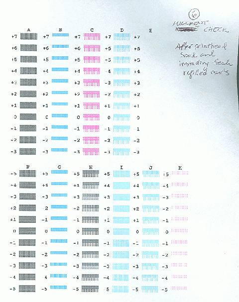

scan 6.jpg - Alignment check after the printhead soak and installation of fresh refilled carts.

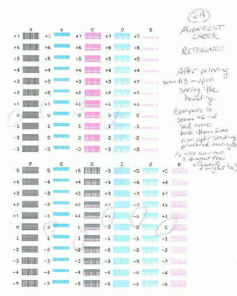

scan 6A.jpg - This is a reference alignment check which I printed yesterday, upon seeing the banding of the light pink petals and the black text which turned to red. This is before my cleaning and soaking of the printhead last night. I had at that time the bottom half (but in teeth configuration) of blocks E and K, and a more filled in C. There was also a magenta line on the bottom half of blocks H. (The circles are what I "thought" the alignment might be based on incomplete printing.) It seems that I have even less ink output than I did before the cleaning and soaking of the printhead last night.

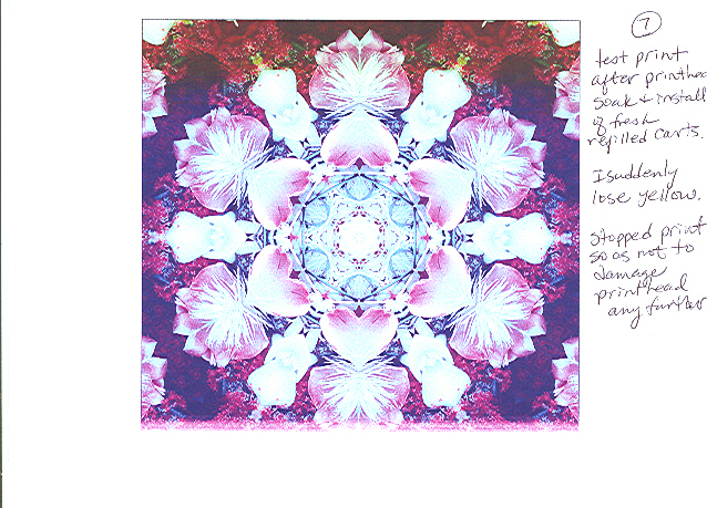

scan 7.jpg. Test print after soaking of printhead and installation of fresh refilled carts. I suddenly lost the yellow. I stopped the print so as not to damage the prinhead any further.

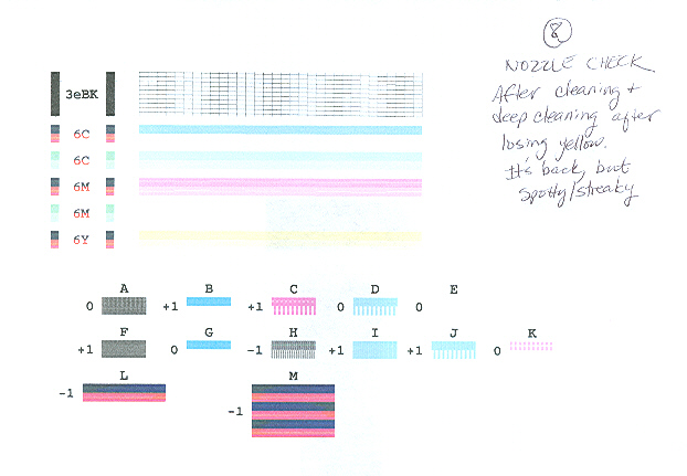

scan 8.jpg - Nozzle check after cleaning and deep cleaning after losing yellow. The yellow is back, but is spotty/streaky.

It is always helpful to know what a "normal" nozzle check looks like to have a good comparison when there is a problem. I keep a folder with prints of the nozzle check, extended nozzle check and alignment tests for just this reason. Without this knowledge, it is necessary to make some assumptions about what is shown.
According to on-line documentation, your i560 has C/M/Y dye carts that will be used to print photos. The nozzle check would also seem to indicate that the cyan and magenta may have an extra set of small nozzles to emulate the "photo" cyan and magenta inks.
The following observations were made from your scans:
1. The "light cyan" seems to be missing from half of the bottom half of the "light cyan" - all of the other colors look OK. The pink on the bottom of the vertical bars is caused by the loss of 1/2 of the light cyan.
2. The light cyan background areas at the top of your print look normal on the magenta and yellow channels. The cyan channel is lighter in these areas, exactly as indicated by the nozzle check. When you print a photo, watch how the paper advances while printing the last part of a page. Does it seem to advance the paper 1/2 as fast as before? It could be that your printer slows down near the end to allow more drying time, and only uses 1/2 of the nozzles during this time. As a test, tape on a small square of paper (like a "Post-it") onto the bottom of the right edge of paper to fool the printer into thinking that the paper is longer than it actually is. This can fool the printer into printing at normal speed to the end of the paper.
3. Given the color problems seen in the nozzle check (scan 4), it's not surprising that the colors are way off.
4. The "dark cyan" is missing on the bottom half of the nozzles, and the "light cyan" is the same as before. The "dark magenta" is now missing from half of the bottom half, and the "light magenta is completely gone. The yellow is now missing from half of the bottom half of the nozzles.
5. Looks to be the same as scan 4.
8. Looks to be the same as scan 4.
Your scans are a good example of why it is helpful to post examples of a problem. A pattern that is this regular, especially when multiple colors show the same problem, usually indicates an electrical problem in the print head, the contact pins between the print head and the carriage, the flexible cables connecting the print head to the mother board or the mother board itself. Pull the print head and use a soft pencil eraser to LIGHTLY clean the gold contacts on the back. There is a spring loaded pin in the printer carriage for each of these contacts, so make sure that each pin is free to move to its full out position. If this doesn't help, you can try buying a new print head. However, you first have to decide if you want to put that much money into an old printer and whether buying a new print head is worth the risk - if the problem isnt in the print head you will have wasted your money. If you could still buy a new 560, the decision would be easy - buy a new printer. You can refill the chipped carts in the new Canon printers, but you lose the ink level monitoring function.
