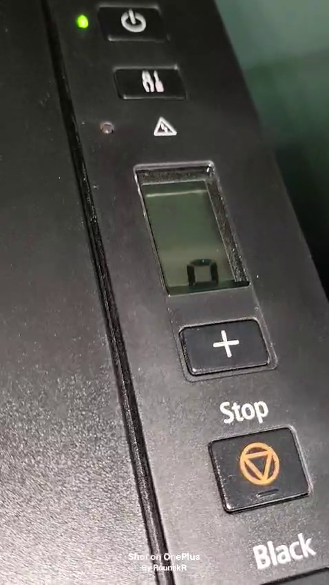

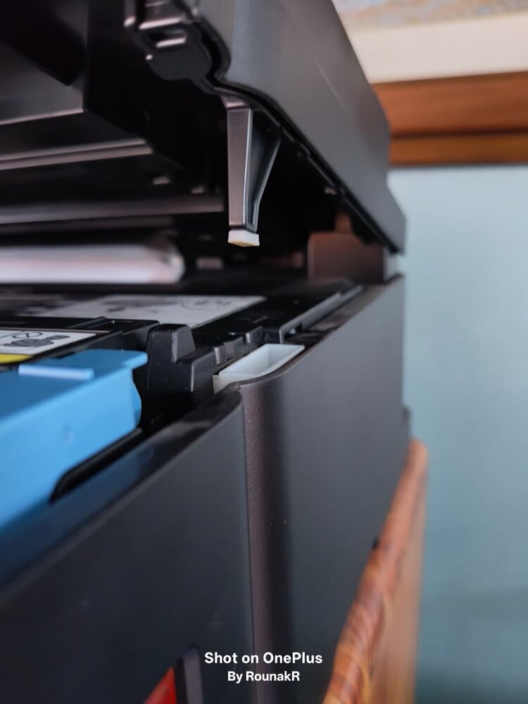

I have a Canon G2010 from 2022 and currently it is suffering from a door sensor issue. The door sensor seems to have come loose or faulty and when any button is pressed on the body it seems to trigger the Top Door open message. I have seen some videos where they just short the sensor and make it a direct connection and other where they use a sort of shim to make the top body plunger a bit taller so it presses more tightly (Like I did in image 2).
I used a foam double side tape to make a soft shim, is it safe to use it like that or will that cause any issues? Canon is quoting a large amount for the sensor change plus it will take a month or so for the sensor to arrive.

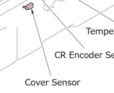

You find a service manual for the G1000-G2000-G3000 series of printers here. At page 75/80 in the service manual It looks like the switch might be similar to the one used in the iP4000, click to enlarge:

Thanks.
The lazy hack works for now.
Yes the switch is like the one you mentioned. Might get it changed from a third party if I can get a hold of the switch from elsewhere.
