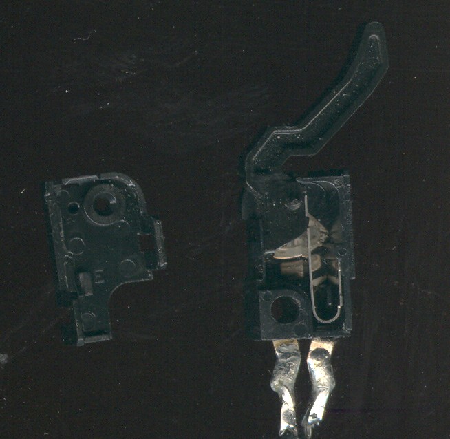

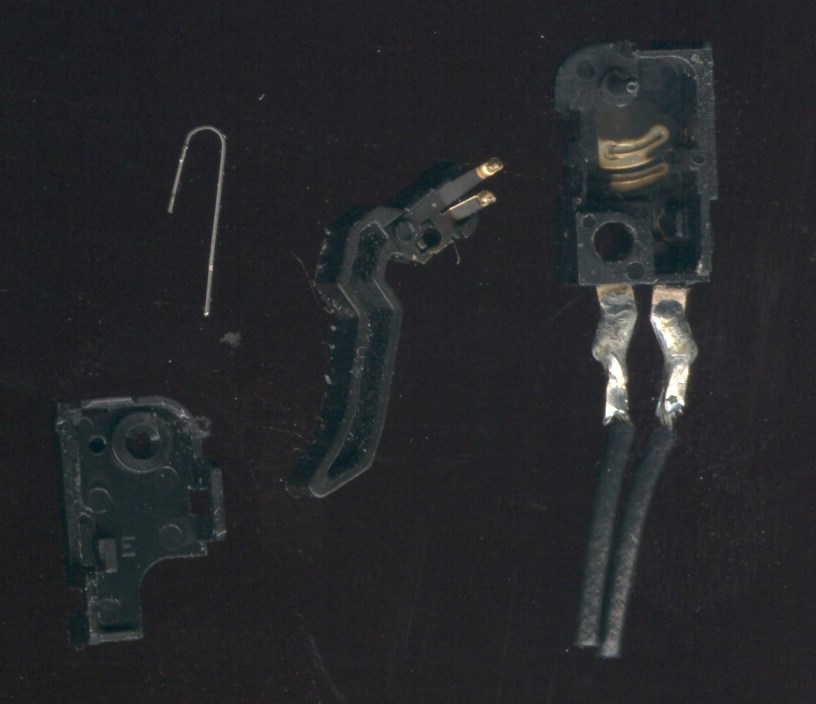

I have had a similar problem with a Pixma 4000. It would sometimes refuse to print or stop in the middle of a print job, giving an error message that the paper output door was closed. The problem was caused by a dirty microswich, giving only intermittent contact, verified by a digital multimeter with a continuity test function. I replaced the switch with one from a defunct Canon printer, after having tested it for proper function. But in case you don't have a spare switch, the switch can be taken apart and cleaned. It is a very fiddly job, and a magnifier lamp and tweezers is a good help in doing this. Here are some images showing how to clean the switch. Click the thumbs to enlarge:
This is a malfunctioning switch taken apart. Note dirty contact surfaces:
This is the switch after cleaning the contact surfaces with a small "Q-tip" made from a wooden toothpick and a little cotton. For cleaning an electronics contact cleaner with lubricant is preferable, but WD-40 also works well. I used WD-40:

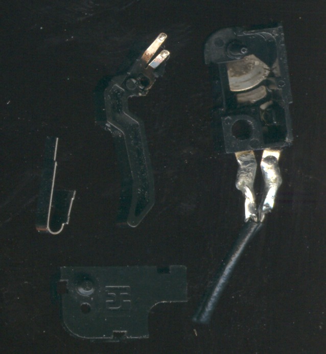

This is the inner works of the reassembled switch:

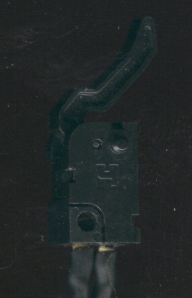

Here is the reassembled switch with the cover in place. Note that heat shrinkable tubing has been added to cover the solder terminals:
The connector from the switch attached to the logic board might be very difficult to detach. Instead cut the wires and resolder them after cleaning the switch and verifying its function. Heat shrinkable tubing should be used to cover the solder joints. If you cut the wires instead of detaching the connector, less disassembly of the printer is required. Don't try to unsolder the wires from the solder terminals. You risk damaging the plastic housing, I made that mistake.
