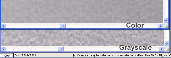

4. I noticed that the grayscale print was "grainier" than the color version. To check this, the same section of the color and grayscale images were converted from color to grayscale (to eliminate any color casts - that will be covered later) and displayed at 400% - the width of this image is about 6 mm (1/4"). There is clearly more "grain" on the grayscale image.
