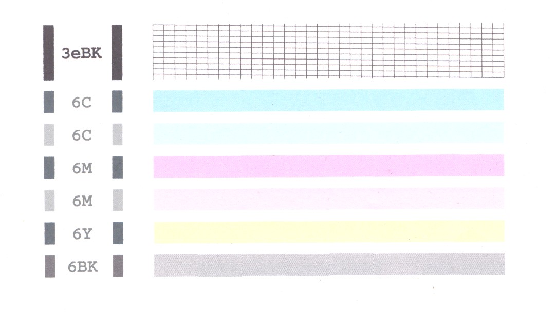

OK thanks I will try to improve my technique. I kept the files small on The Hats advice. As to the problem to the left of the rope are a series of black bars like railway sleepers, and across the top and bottom is a single stripe which looks bluish/cyan on the Mono print.
The nozzle shot was to show the difference between the thickness of the BK strip after doing 5 nozzle check cleans. Unfortunately I could not get the other shot to load. Kept getting the red error message although I was doing exactly the same sequence.
Anyway it looks as though narrow BK bands must have been a blockage because each clean gradually increased the width until it reached the same width as all the others. I then printed out a Mono picture without any of the bands showing (different picture)

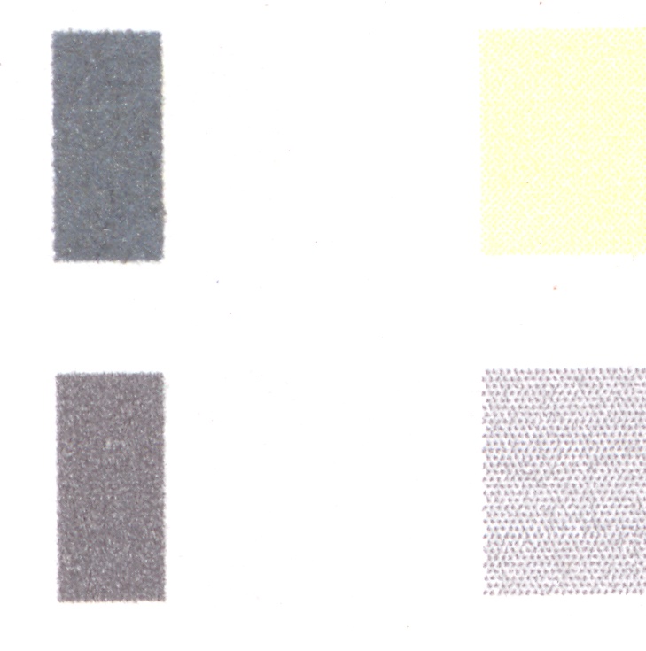

Thanks to some help from ghwellsjr, one of the admins, your pictures finally show. As stated by ghwellsjr you can have more detail. Here is a nozzle check I scanned at 200 dpi and cropped using Irfan View. I also let Irfan View compress the picture to 80 kB or less. The scanned and cropped image was 1.9 MB before compression. Here is the nozzlecheck:

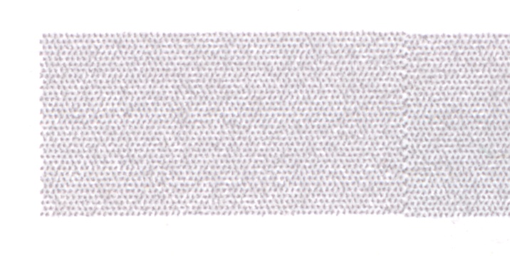

If you crop your pictures really hard, you can use a higher scanner resolution. Here are details of the photoblack nozzlecheck scanned at 1200 dpi. These are thumbs, click to enlarge:

If your pictures are large it is a good idea to show the thumbs in the text, and include the words: "Click to enlarge". If you right-click the thumbs URL from the upload page and copy and insert in your text, your thumb will automatically enlarge to your uploaded picture.
When writing a post with pictures or thumbs inserted, you can use the preview button to check your post before submitting. You have the possibility to correct your post until you are satisfied with it. Determining the best resolution could take some trial and error.
So could you try to re-upload your pictures in a higher resolution? It also a good idea to include a small crop scanned in high resolution to better show details.
As your problems are in black when printing photos, I think the problem is with the photoblack. If you have another photoblack cartridge you could try that and see if that is better. If your printer is OK with another cartridge, the photoblack cartridge most likely needs purging and drying. You could also try a few regular nozzle cleanings from the printer maintenance. Deep cleaning has no advantages, it only wastes more ink and dumps more ink into the absorbers.
Edit: I see you posted while I was writing this post, so one addition: Don't buy a set of compatibles, it is better to buy one a new OEM photoblack for testing.
