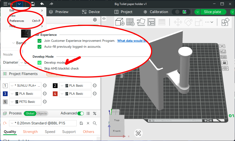

Over the holidays I have been playing with Bambu Studio i.e. exploring the menus in an effort to get a better understanding of the options. A friend mentioned a menu item that I had not come across before which opens up some of the things that I liked about the Orca slicer that appeared to have been taken away with Bambu implementation, i.e. the calibration options. TBH I have no idea how long this option has been in Bambu Studio!
Of course I could be the last one on the planet to hear about this but FWIW I thought that it may be of use to others.
Explained in the screenshots

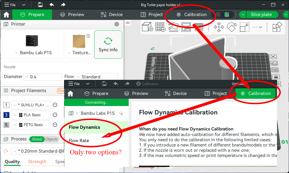

  • When you first open Bambu Studio in the menu section you are presented with a Calibration tab, clicking on this only gives you two options. Disappointing compared to Orca's offerings
  • However, there is a hidden menu item. Well an option that is not enabled by default. Click on the down arrow next to the File option in the top menu and select Preferences>scroll to the bottom of the dialogue box to Develop Mode and tick the Develop mode box.

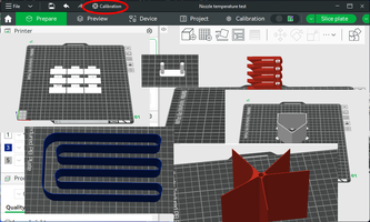

  • Now you should have a new Calibration menu at the top menu line which opens up some of the missing calibration options
The calibration options are still not as comprehensive as Orca slicer as they do not seem to have been updated in the Bambu application. Still I hope this may be of use to others using Bambu Studio
