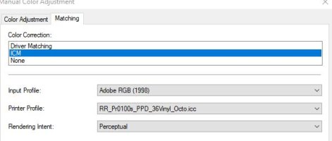

I've been trying to get my Canon Pixma Pro 100s to print in Adobe RGB colour gamut instead of sRGB. I spent a lot of time trying to download and install the AdobeRGB .icc file but it never seemed to work (can't select it from Printer Profile in the driver and the only .icc file I can get from Adobe is only 1kb in size so I doubt it's the actual working file).
However I did manage to download *something* from the Adobe site and then installed it. I wasn't sure what it did but I did notice that in my Canon driver, in Main tab > Color/Intensity (click Set) > Matching tab > Select ICM from Color Correction then Input Profile drop-down menu (see attached picture!) there used to only be an option for "standard" for the Input Profile, but now there's an AdobeRGB(1998) option as well.
I found selecting this actually allows me to print out in the AdobeRGB colour space without specifying it in the software I'm using (which effectively has no colour management so I can't select any printer profile from there).
I'm just wondering if anyone knows what I did. I tried for ages to download and install the AdobeRGB .icc profile but the only file I can find is 1kb in size so I doubt it really is the .icc file, and copying it into the correct windows folder doesn't actually make it show up in the Printer Profile menu anyway.

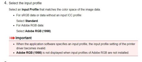

Does anyone know what it was that I installed for AdobeRGB to show up in the Input Profile? I attach a second screenshot, this is from the Adobe website stating that AdobeRGB is only available for the Input Profile if you've installed it, but I can't actually remember what I installed, where it came from (other than it was somewhere on the Adobe site), what sort of file type it was etc.
Can anyone help? I'm just worried that if I ever need to replicate what I did I won't be able to do it!
Thanks :)

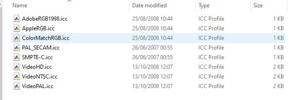

Can you tell me where you got the adobe.icm profile from? I've been trying to get the Adobe ones but even from their own website they don't seem to work. If you go here:
https://www.adobe.com/support/downloads/iccprofiles/icc_eula_win_end.html
It allows you to download a .zip file with a load of profiles in it, the issue is they can't be the correct ones as all the RGB ones are only 1kb in size (see attached picture). You can right-click these and Install Profile or manually move them to the correct folder, but they then don't appear in any menu as a selectable option. I'm guessing Adobe don't want people to have access to them and they replaced the actual files with some sort of dummy file?
Edit: I'm on a desktop PC running Windows 10

I'm probably not being clear in what I'm asking....so this Canon website:
https://ij.manual.canon/ij/webmanual/PrinterDriver/W/MG2500 series/1.0/EN/PPG/dg-c_color_correction03.html
The first paragraph states:
Printing with ICC Profiles​
When the image data has a specified input ICC profile, you can print by using the color space (Adobe RGB or sRGB) of the data effectively.
Then a bit further down on that page:
Specify an ICC Profile with the Printer Driver, and then Print​
Print from an application software that cannot identify input ICC profiles or does allow you to specify one by using the color space of the input ICC profile (sRGB) found in the data. When printing Adobe RGB data, you can print the data with the Adobe RGB color space even if the application software does not support Adobe RGB.
Then there's the above part. Somehow I managed to get "AdobeRGB" to appear in the Input Profile drop-down menu, when before all that was there was "Standard". Problem is I don't remember how I did this,
I actually contacted Canon and they don't know either! :-/
I'm guessing the option I now have selected tells the printer / software to use AdobeRGB colour space rather than sRGB. It definitely makes a difference to the printer output though, colours are more saturated etc.
if the software does not support color management, it is unlikely that it can send data to the printer in Adobe RGB color space. If you manually set the printer driver to expect Adobe RGB input data, it will interpret the input data wrongly, which probably leads to the changes you see in printer output.
There is two things two consider: the color space of the input data and the color space of the printer/paper combination.
The input data is usually in a working color space such as sRGB, Adobe RGB or ProPhotoRGB. So if you want to make use of a larger color space, you need input data that actually fills that larger color space. That starts from recording the image either in RAW, or if you use JPEG setting the camera to use Adobe RGB. And then you need the larger color space as working color space throughout your editing workflow. My personal recommendation would be to go with ProPhoto RGB instead of Adobe RGB, since the capabilities of modern inkjet printers already exceed Adobe RGB. I wrote a bit more on this in an article on ProPhoto RGB on my blog.
For the for the printer/paper combination you have ICC profiles describing the available color gamut, either generic profiles from the printer or paper manufacturer, or individual profiles created for your specific printer by yourself or a service provider.
Then you need to make sure that the input data is converted properly into the color space of the printer/paper combination. This can happen in the application if it has that capability, like Photoshop or Lightroom do. In that case you disable the matching in the printer driver, by setting that correction option you showed to „None“. Or it can happen in the printer driver by choosing the right ICC profile there.
So your misconception is that you can just make a setting in the printer driver to use Adobe RGB, when there is much more to it.
What is the software you are using, and how does the input data look like?
