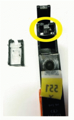

For users of canon 551 carts, here is a german workshop for refilling:
http://www.druckerchannel.de/artike..._betanken_sie_canons_neue_single_ink_patronen
- on page 3 they cut the chip just to show that it will be destroyed by doing it.
- there also is a photo which shows the difference between standard and xl cart:
the standard cart has the wall to reduce the ink chamber, it is sealed - the rear wall in the standard cart is NOT sealed, ink will come out if you try to "expand" the reduced chamber.
I don't really know if you already considered this potential leaking..
Refilling method is "german / durchstich"
PS: 11ml of ink is ridiculous to call "extra large", 7ml is absurd..
..how low will they get in future - just a sponge with 1ml???
16,164
9,116
I have already covered that in my first thread, the hole in the standard cart is easy to fill as shown in this pic,
use either hot glue or Adhesive for the job, but youll still have to navigate the inner wall.. :(
