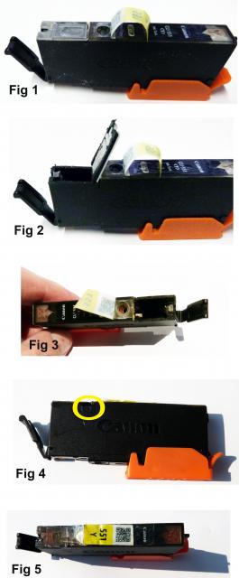

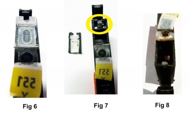

What I set out to do was to remove a section from the top of the cart top over the unused area of these set-up OEM carts.
I peeled the label back and made a cross cut of about 2 mm on the cart top beside the refill ball,
this section on the top is made of almost clear see through plastic.
Then I made the second cut just under the clear piece of plastic again 2 mm deep till it met the cross cut on the top.
The next step was to drill a 6 mm hole into the dividing wall between the two compartments as close to the top as I could
and I then moved the drill bit downwards till Id got to the bottom,
I used the side of the drill bit to cut away the plastic wall and not the tip of the bit.
I then cleaned up the edges of the inside wall with a hobby knife and then used a small pliers
to nip out the remaining pieces of the wall that still remained beside the now clearly exposed prism.
All I had to do then was to glue the top section back onto the cart using (Araldite),
there is a clear piece of plastic running from the bottom to the top at the very back of the cart,
and its used to help transmit the red LED on the underside of the cart which has to be sealed also.
I put a good amount of adhesive on this plastic section as well as the sides of the cart and then put this piece back into position on top again.
I left the cart to dry over-night in an upside down position slightly tilted
favouring the back of the cart to keep the adhesive around the clear plastic piece where the hole was.
Next day I taped over the air maze and pulled out the refill ball but decided to refill the cart using ink instead of water,
messy I know but it helps to concentrate the eyes that bit better while watching out for leakage.
Refilling was very easy because I could see the ink inside through the clear plastic top;
I then put the refill ball back into its hole and covered the ball over with a bit of hot wax.
Once the cart was sealed I squeezed the side-walls while tilting the cart from side to side to check for any signs of weakness or leaks,
it turned out that I did in fact have a small leak in one of the side-walls very close to the top.
I mixed up another small amount of Araldite and rubbed it firmly into the crack and then later checked again and it was fine no leaks,
so no matter how much I squeezed the cart now it doesnt lose a drop of ink. (Job done)
I removed the electrical tape from the air maze and cleaned away the small amount of ink that had escaped while I was testing,
I then decided to remove the orange clip from the bottom and blow gently into the air maze
just to make sure it was clear and that the cart leaked a few drops of ink easily from the outlet.
Fig 1. Shows where I made the first cross-cut. Fig 2. Shows the second cut with the top piece removed.
Fig 3. The prism is just visible after the removing the inner partition. Fig 4. This shows the cut in the side wall that sprang a leak.
Fig 5. The finished cart with the colour label crudely taped on. Fig 6. The top piece in position ready for Adhesive.
Fig 7. Shows the Plastic for the LED light and the hole in the back of the cart. Fig 8. Is the same as Fig 3. Just from a different angle showing the prism location.

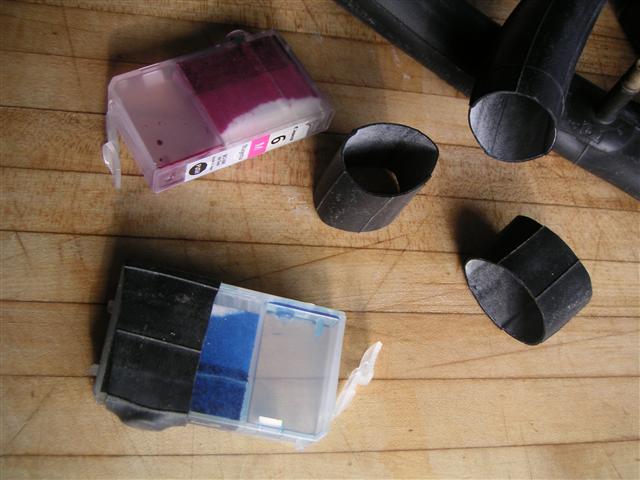

Hmm... so it might appear that an approach like the rubber inner tube (ref) or similar might work to provide the required pressure/seal.
Take your point on the Epson carts as well Mike.
I'll probably get a couple of third party carts to see if the orange clips for those are compatible with the OEM coupling points and, if they are, whether they do a better job of sealing as with the earlier Canons.
