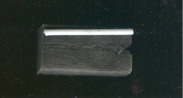

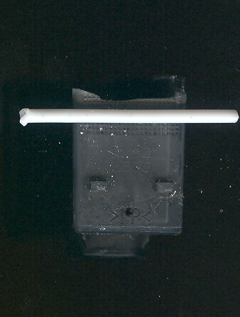

Here is the position of the refill hole. It is seen it is slightly above the recommended centre of the >< markings. Click to enlarge:

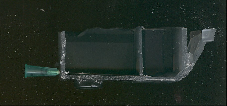

Even if the hole is placed slightly above the recommended position, the needle slides close to the bottom causing damage to the bottom sponge and risk of separating the bottom sponge and the outlet filter. Click to enlarge:
And here is the damaged sponge. I use 2" 21g sharp needles to minimize damage, but maybe using a big sewing needle to drill a channel and then use blunt needles could be less damaging? Click to enlarge:
I think the cause of the problems was that the sponge and outlet filter had separated and/or that the bottom sponge had been pushed into the the grooves as suggested by Grandad35. So even if I like the German refill method with squeeze bottles very much, I think that for the newer and seemingly more fragile cartridges, topfilling is the way to go, and I will start topfilling these cartridges, hoping that I will have fewer problems with them in the future. Topfilling will also have the added bonus of Grandad35's drip test available. I will continue using the German refill method with squeeze bottles for the older cartridges though, as I still like this method very much.

Some very interesting posts and observations that can be very useful to everybody. Right from the beginning when I embraced the German method I considered the needle hole position critical and designed for the BCi carts I was using at the time a paper drilling jig.
The case thickness is about 1/16" so I calculated that the hole should be 0.0625 + 0.0020 to give a small clearance above the bottom and to slide along the bottom and NOT cut into the sponge. It was centred as well which is not so critical. I was still concerned however that you are forcing a gap between sponge and output filter which could cause problems.
