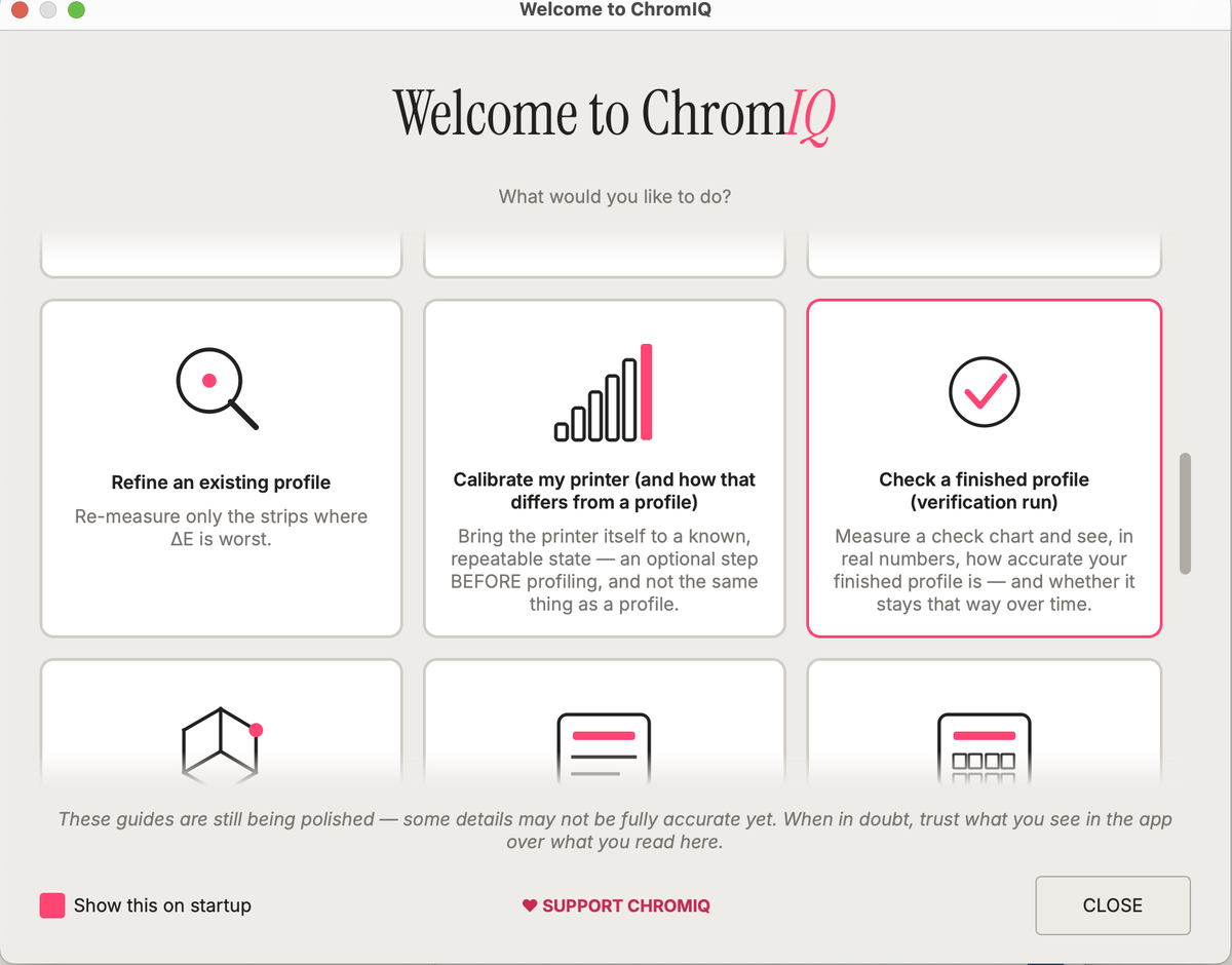

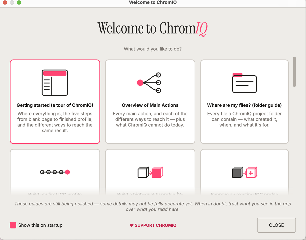

This is interesting. Since you obviously have good thoughts and experience in correct validation of profiles, could I ask you to test the Verification feature on ChromIQ? Would you do the community this favour?
The hope is that this verification step will give detailed test data proving a good quality profile. Your help and sharing the results would be highly appreciated. Maybe this would satisfy your need for proving your profile's quality? Tell us what is missing please.
Do the following:
  1. After a profile is created a change the Run Type parameter from Profiling to Verification,
  2. select a chart (make one or select a preset). Help is given on which charts to select from the presets for verification, based on metrics that are tested in the Measurement Report, using the button "Which presets can be used for verification?" under the "Select preset" pulldown in the Create Chart tab (manual mode or "From Profiles's Gamut" mode).
  3. After deciding on a chart, click on From Profile's Gamut to fill the chart with colors that the profile can reach, press Generate Chart.
  4. Print that chart "raw", without color managemnet, as the colors in the chart already has the profile applied to them.
  5. Measure the chart. Measure through the whole chart, and then check if there are any red highlighted patches (the neighbour-check may change highlighted patches as more measurements are completed). Re-read patches that are red, or those you find suspect based on the information given when hovering of a patch.
  6. When measurement is completed, Open the Tools --> Measurement Report. Make as many reports as you want, and any type you want. There are two ISO 12647 report types with accompanying limit sets. Each limit set (the "judged by" parameter) has a defined set of metrics that is tested, or you may choose which metrics to include, and which limit values are acceptable. The ISO 12647-7 and ISO 12647-8 limit sets, for the "Contract proof check" and "Validation print check", have fixed thresholds given by the ISO 12647 standard, but using the Custom ISO limit sets you can define whatever you like for these also.
  7. Print the report as PDF, as you wish.
Use the latest beta in: ChromIQ releases
Edit:
I might have skipped some steps here, but to read more about verification runs, read the Help Cards (click on the question mark in the corner) for "Getting Started (a tour of ChromIQ)" and "Check a finished profile (verification run)":
