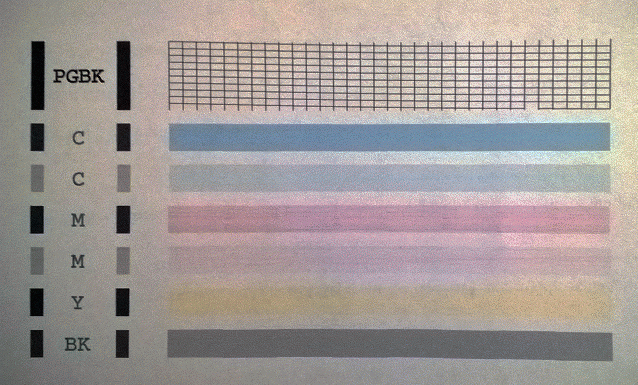

Could you upload a scan of the misprinted flower photo? A crop clearly showing the misprint and a part that prints OK is sufficient. Could you also upload a nozzle check from the failing printer?

OK the first thing I have to say is STOP printing your documents/Photos immediately and don’t print any more till you can resolve this issue.
Yes you have a problem but you’re going about it all the wrong way and getting your printer into bigger problems, like permanently damaging your print head.
Let’s deal with your clog issue first if it is at clog at all, what you need to do is to print a nozzle check which looks like this.
By examining this printout you will see clearly which colour is failing to print, now run a deep head clean (One only) and then print another nozzle check.
Then compare both of these nozzle prints and see if there is any differences in them (Improvements of missing segments). (Your missing Yellow)
If not you will need to replace the cartridge of that missing colour with a new one and then run a normal head clean followed by another nozzle check.
You should now have all the colour working normally again but if you don’t you may have other issues, like a difficult ink clog or worse a damaged print head, you should post all 3 nozzle prints on here to get a better diagnosis.

Post a nozzle check.
PS: the Hat was first...stop printing until the nozzle check is flawless..

I did nozzle checks throughout the course of the testing I described, and all were perfect. Or so I thought at the time.
But I did one again just now, and finally noticed that - duh! - the photo black strip at the bottom wasn't printing anything at all. Completely blank. Most likely that was the case before, and I missed that before, multiple times, just as I almost did this time. I've been looking at Canon nozzle checks for over 10 years, so I have no excuse.
Sure enough, the LED on the photo black cartridge is blinking, although no error shows up on the LCD panel or the software, now or earlier. We checked the cartridge LEDs when we first noticed the error, and it wasn't blinking then. But we've had a lot of problems with the resetter giving a good result, no blinking cartridge after inserting the cartridge in the print head, only to end up with a blinking LED and front panel error after the printer was closed up, so likely I missed that one as well.
I'll have to get a working photo black and test, but at the moment it looks like the complement of purple is photo black.

Putting a functioning photo black in place completely solved the problem. True black in the original prints as purple if photo black is not functioning, at least for an MX892. Interestungly, slightly off-black portions in the original printed ok with a non-functioning photo black.
