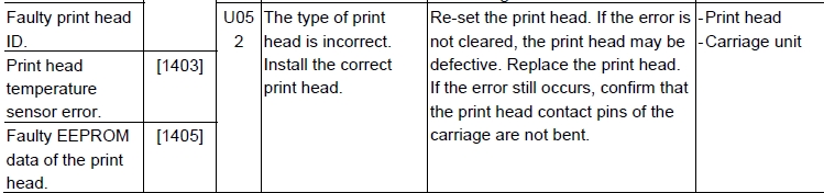

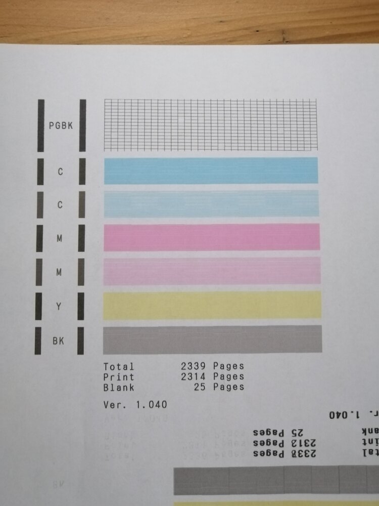

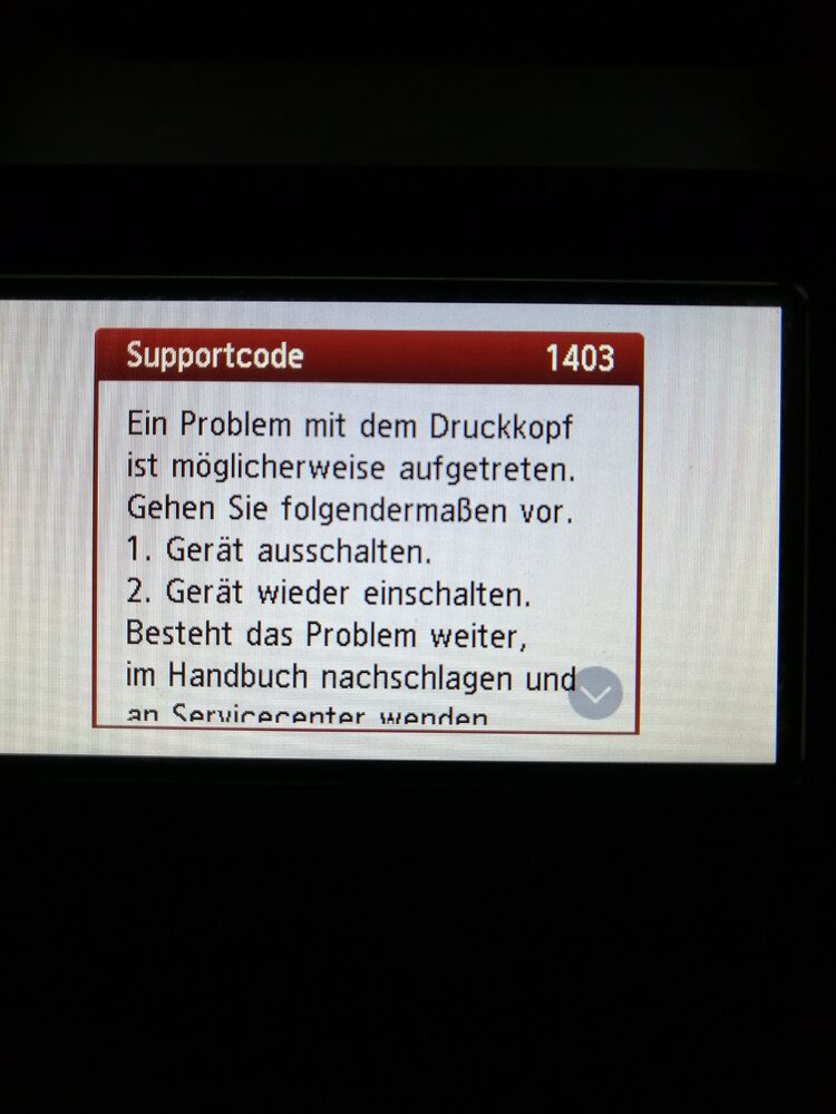

Today at 9:12 AM #1 F fenster Print Lurker Joined May 22, 2025 Messages 1 Reaction score 0 Points 1 Printer Model PIXMA TS9550 Supportcode 1403 how to deactivate Canon PIXMA TS9550 reinstall printer head and it works for a short time Nozzle test ok Attachments IMG_20250516_075625-2.jpg 80.1 KB · Views: 9 IMG_20250518_100259.jpg 69.4 KB · Views: 8
