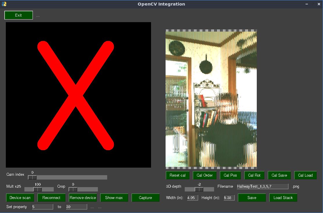

Within each lens, there is room for only so many frames. If the lens count is 50 per inch, then at 100ppi printing I could cram 2 frames. True, I don't have to care too much about resolution here. For 50 line/inch lenticular sheet, I resolution along one axis is fixed at 50ppi
You are using 10 cameras so what are they and what is the pixel resolution per camera?
I'm using 2MP (1920x1080) camera boards, like this one. However I plan to upgrade the cameras to a similar 5MP version. Actually my real problem is that I don't have access to some of the settings on the camera that I would like to control. It's a real mess requiring lots of bandages. I may have to find special cameras
What size of print are you aiming for?
What software are you using and what does it recommend?
I was wanting to do 7x5" prints (because a supplier has this size of lenticular sheet premade with adhesive backing on it), but now that I'm concerned about resolution, I'm going to aim for larger: Letter size ~8x10"
I wrote the software in Python. I'm using opencv to talk to the cameras.
