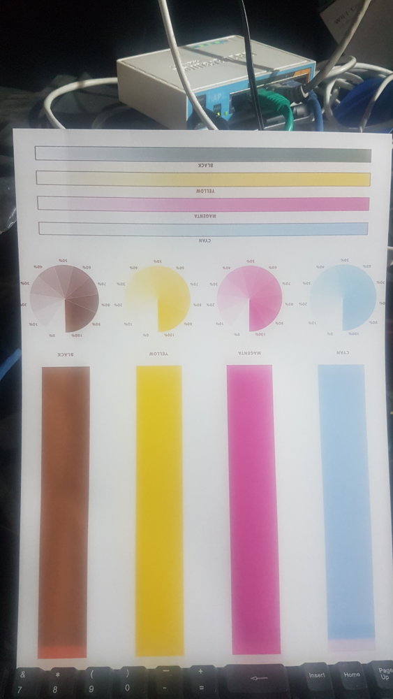

Can any one tell me what ink appears blocked from these images. Its on a Epson SX600FW
IMO, It does not appear that any colors are "blocked". The brown(?) bar on the left side probably should be in shades of grey, like the top-most stripe.
Please post a nozzle check print instead of the "test" print.
Its is all of black and 99% of blue that is blocked. I was not sure as it would not run a nozzle check.
I managed to get it to run now. I have a major p[problem with this SX600FW as I cant see much about them and certainly not how to remove the cartridge cover without breaking it and also how to remove the printheads as its REALLY blocked badly now.

I did not recognize that there were multiple images attached to your post, and "focused" on the first one.
While clogging/blocking can occur on Epsons, this type of issue can also be caused by air-binding (air in the nozzle chambers rather than ink), particularly if the nozzle check "varies" from nozzle check print to nozzle check print.
Why would it "refuse" to run a nozzle check print? That's weird behavior...
Wait overnight and try another nozzle check print, compare it to an earlier one, and report back.
