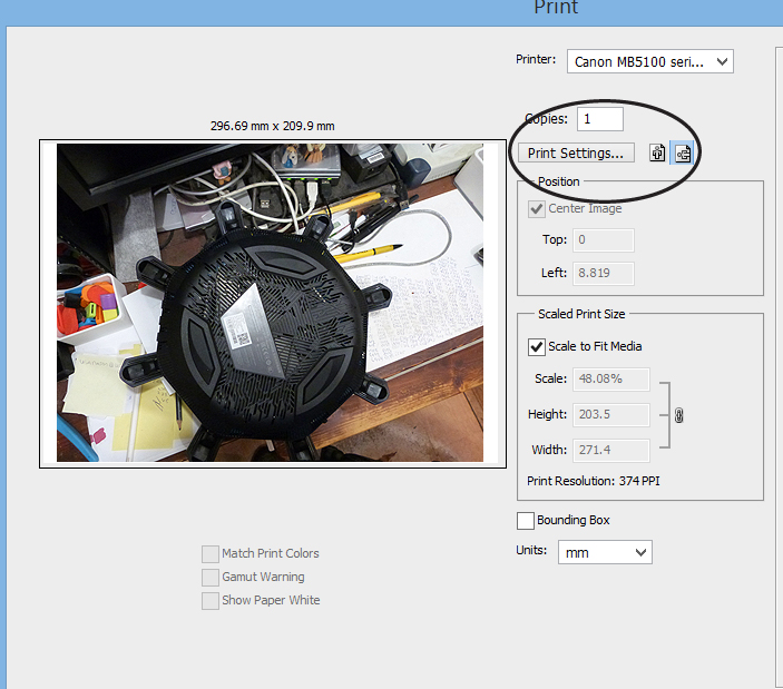

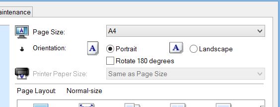

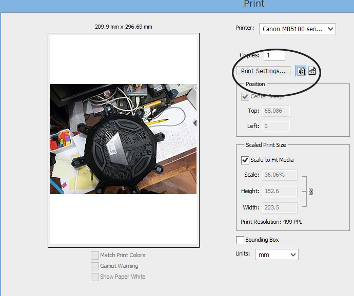

Here is a Pic displayed in Photoshop ready to print Portrait and then again in Landscape, note the Print Setting differences.
Capture23.JPG Capture24.JPG click to enlarge..
And this is where to find your Printer Default paper setting..
View attachment 12641 View attachment 12642 click to enlarge..
Thank you. Yes I am aware of the difference in the two. The issue is more, prints that are formatted to be printed horizontally on the left hand side of a 44 inch roll of paper are printing on the right side of the paper vertically... sometimes cutting off part of the the image.

Am I missing something - the screen prints above of the printer settings show a printer 'Canon MB5100 Series' but not settings of a P10000 ?
Correct because I don’t have a P10000 but the principals are the very same in Photoshop..
