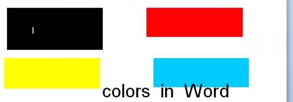

toutes les couleurs sont de marque SUDHAUS...sur du papier ordinaire 90 g en impression " haute "...
Hello
all colors are SUDHAUS brand....on 90 g plain paper in "high" printing ...

Can you reprint it again please, but this time on a sheet that has no image on the reverse side..

there is like a veil on this result ... unclear impression ...
il y a comme un voile sur ce résultat ...impression pas nette ...

Your Nozzle check is a bit light, but ok, and your manual colour adjustments are way off, try moving them back to the default position, Click on the Default button, then try your colour test sheet again..

I clicked "by default" .. the result is the same as before on the test sheet and with the 4 squares of diferent color ..

I put another cartridge, I set everything to the maximum (cmy + intensity and contrast at 50) ... the result is + red but the black is gray black

even with this new configuration the printing is never clear, it is as if there was a slight veil on the result even when printing the stamp images on glossy photo paper with the "glossy paper" option, high quality. .I don't understand ... I did at least 200 tests ...

You did not identify the printer. What is it?
You said you use Sudhaus. Are these prefilled cartridges or bulk ink you refill the cartridges with?
Your MP550 has a Magenta cartridge. There is no Red cartridge. The nozzle check is supposed to demonstrate the ink in its unchanged state, ie no mixing of other in colors.
The Magenta swaths do not look correct to me. They do look a little towards the Orange spectrum.
Check your ink. Did you refill with the proper color? Is there contamination in the Magenta cartridge from a nearby leaking cartridge like Yellow?
The choice of paper can have an effect on color shifts as well. Try other paper.
The choice of Paper Type in the printer settings can also cause color shifts you might not like.
You may need a custom ICC Printer Profile to get better color fidelity. An ICC Printer Profile tells the printer what to do for ONE spefic paper, One specific ink and One specific printer model. Change any of these variables and color fidelity may change unpleasantly.
The Pigment Black latticework shows disruptions. This may be due to clogs or permanent electrical malfunction. If these are clogs then they may go away with regular printing or a Regular Cleaning or two.
