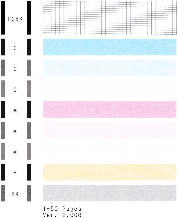

mg5450_ncp-jpg.1441
I think it is same as QY6-0080 (except for font).
Overall brightness is due to scanning options.

According to my count the uploaded nozzle check shows 16 x 32 = 512 PGBK nozzles. I checked the European Canon sites for printer specs, but found no info about number of nozzles in the print heads. I wonder if the Canon US site is wrong?
It often takes some tweaking of the scanner settings to get a good scan of a nozzle check, else the light magenta and cyan stripes tend to disappear.
