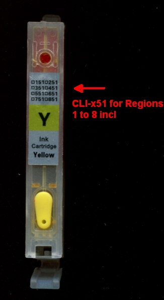

You never know with Non-OEM Chips. Maybe they made a universal CLI-42 chip? It might be possible. Here is a scan of a CLI-x51 Y refillable cartridge with an ARC chip. It seems to be universal for all 8 Canon regions, click to enlarge:
If the chip in my cartridge is the original one the chips in that cartridge is still region specific(had to swap from 351 to 651)

Yes an OEM chip transferred to a third party cartridge is still an OEM chip and still region specific. But the chips om my refillable third party cartridges are not OEM but third party ARC and claimed to be non region specific.
Sorry what i meant was the chip in that style of refillable cartridge with that labeling could still be region specific(atleast if the ARC that was installed at the time i needed 651 cartridges were the originals that came with the refillable cartridge - Had run 2 x51 printers of differing regions at one point so it could have been a swapped ARC).
