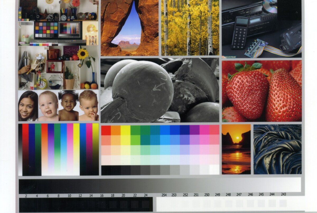

I bought a Precision Color refill kit for my Canon Pro-10 back in June. I didn't see it right away, because it took some time for the refill inks to work their way through, but I recently noticed how bad my prints were coming out. I made a new ICC profile just to be sure, but I'm still getting really poor results.
I know they changed owners earlier in the year, and I've never ordered a set of pigment inks from them before, so I didn't know what to expect. I wanted to check if this quality is typical, or if I should contact them about it?

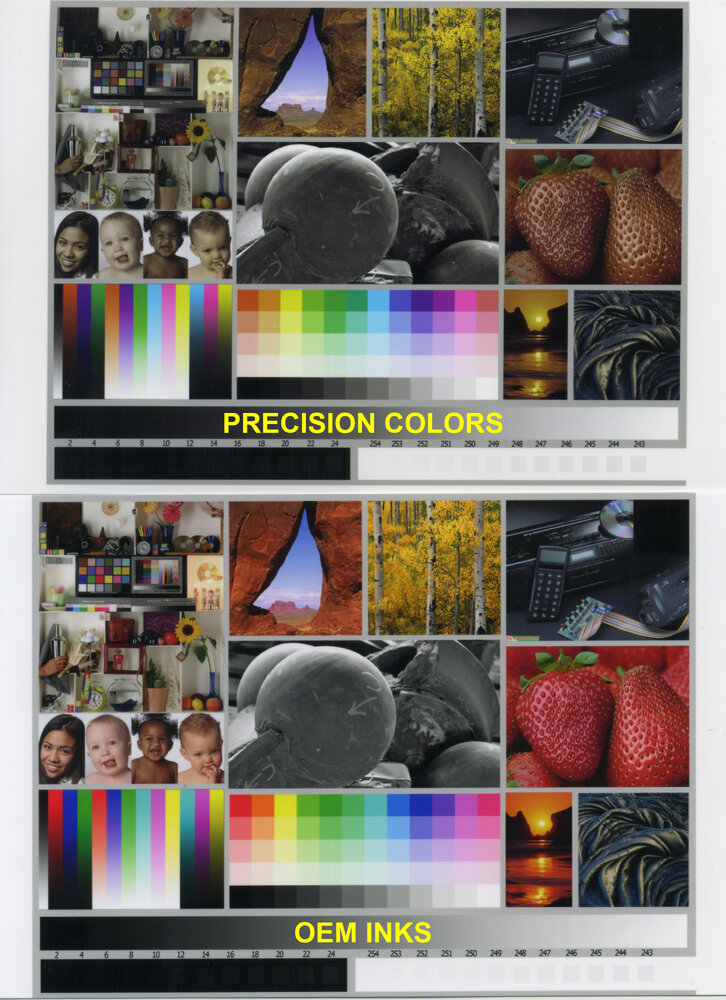

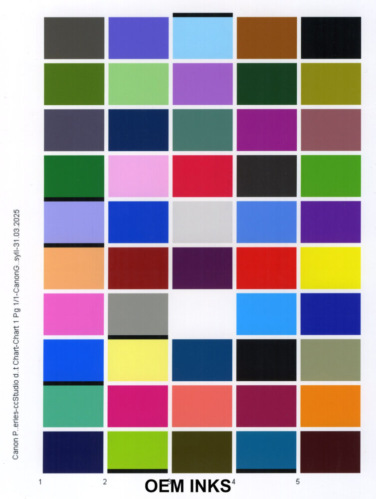

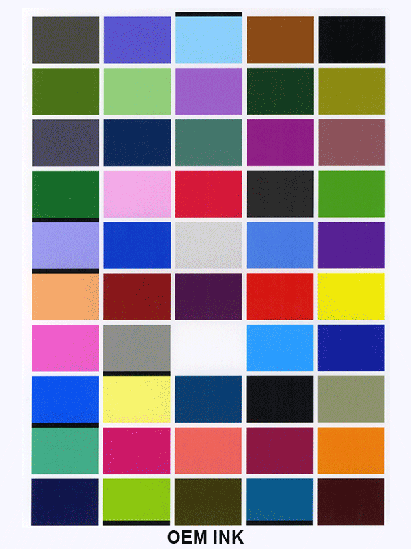

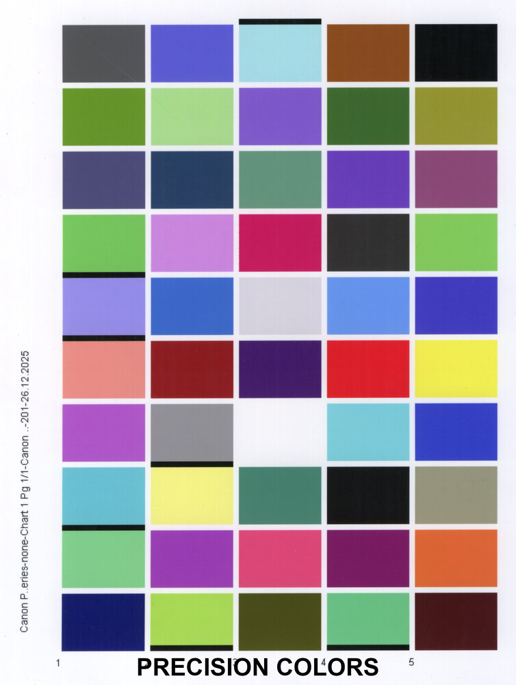

Here are the initial charts from ccStudio (Calibrite's version of X-Rite's i1Profiler software). The charts are color targets printed directly from ccStudio, and then scanned with my scanner, so I assume these are comparing apples to apples:
Hopefully you can tell how much weaker the colors are compared to OEM.
The following are test prints with their respective ICC profiles made with ccStudio. You can see how dim the red/magenta & cyan inks are for Precision Colors. Skin tones are a horrible gray with a greenish tint. Reds come out closer to orange, and the blues drift into purple.
