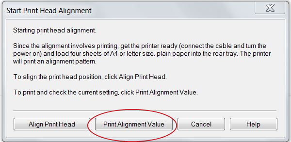

Regarding the refusal to perform auto-alignment functions, what does the manual alignment option produce??
I reckon a far better alignment in every respect because you control the final output.
Print the previous setting before making any new adjustments.
I never use the Automatic head alignment..
It produces a number of patterns where you have to choose the best.
I never understood how the printer could "see" this itself to adjust automatically.
But IMO this has to do with the timing of the printhead movement and nozzle firing, not with nozzle remapping.
5,142
5,028
A photo sensor on the underside of the print head carriage checks the printed patches for unevenness. You choose the least striped patch when doing a manual print head alignment, the sensor does something similar when an automatic alignment is done.
