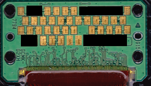

When you take out printhead from printer, then you can see green plate with small golden plates on the printhead back - it is printhead connector. These small golden plates are called "pins" or "contacts".
The simplest solution is to put small rectangles of electrical tape on certain pins on printhead connector, and then put printhead back to the printer.
There are three possibilities:
1. Disabling all printing nozzles (chance of fending off "error B200" is about 95%), but printer won't put ink on paper:
If it is OK to having scanner only printer it is enough.
Now printer can be used with empty inks with no risk of further damages from overheating printhead.
Empty inks can be enabled by disabling ink level monitor.
2. Disabling color nozzles (chance of success is 30-50%):
gy6-0080-pinout_m_cl_off-png.1398
If "error B200" perished with these seals, then printer is still capable of printing in pure Black & White with use of large black ink tank. Rest of ink tanks won't be used.
3. Disabling Pigment black nozzles (chance of success is 10-20%):
gy6-0080-pinout_m_pgbk_off-png.1397
Very rare situation. Pure Black & White is disabled, large black ink tank now can be empty. But all colors (including small black ink tank) are still usable.
Situation 2 and 3 is also described here with some details:
http://www.printerknowledge.com/threads/pgbk-doesnt-print.9121/#post-71495

owkay...so i got my exacto knife out and puzzled out tiny wee pieces of electiecal tape. first i tried solution #3, nada.
Then #2...same....
so i tried #1 of ur solution and now i get error code U052 - 'the type of print head is incorrect. Install the correct print head' urg >_<
So... is it percussive maintenance time?

Sorry to hear that :(
That means badly damaged printhead (fried one of two temperature controls).
Sometimes "error U052" is in pair with "error B200". B200 is higher priority, so U052 is hidden. When B200 is cleared, U052 appear instead.
Error U052 can't be suppressed just with electrical tape.
There is one thing left to try (best if combined with p. 1. pin sealing):
