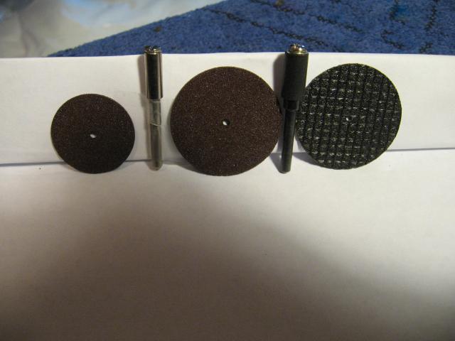

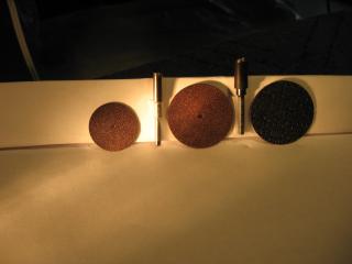

I have some cutting accessories that I can use in removing the top. Below are pictures of the accessories. Also, I have created a description of the accessories.
Description of accessories-- Starting from the left:
409 15/16 cutting wheel. Thickness of wheel is .025 (.6mm).
402 mandrel. This is the mandrel that Dremel says one should use with the cutting wheels.
540 1-1/4 cut-off wheel. Thickness of wheel is .0625 (1.6mm).
430? 1/4 mandrel for a 1/4 sanding band. I also have a 407? 1/2" mandrel for a 1/2 sanding band.
Note: I am thinking that I can use either the 1/4 mandrel or the 1/2" mandrel with the cutting wheels. I will be contacting the Dremel site to see if it is possible to use the 1/4 or the 1/2" mandrel with the cutting wheels.
Question: Can one use the 1/4 or the 1/2 mandrel with a cutting wheel?
426 1-1/4 fiberglass reinforced cut-off wheels. Thickness of wheel is .045 (1.1mm).

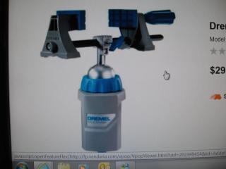

Below is the picture of the Dremel Multi-Vise 2500-01 that I will be using to hold the cart while I am removing its top. I will be purchasing the vise from Home Depot. The cost will be $30.00 plus shipping.
Question: Is there another vise that would be better for holding the cart?

1. Use the Dremel rotary tool with a 409 cutting wheel with the 402 mandrel. I may use a sanding band mandrel with the 409 cutting wheel.
2. Use a mini hacksaw or a jigsaw. The blade will have very small teeth and the thickness of the blade will be as thin as possible.
Note: No matter the method used I would like to remove the smallest amount of material as possible. I will be using the Dremel vise or some other vise to hold the cart.
Question: I will be using LOCTITE Marine Epoxy glue (setting time is two hours) to reattach the piece to the top. Is there a better glue that I can use to attach the piece?
Question: If I use the Dremel rotary tool, what is the best technique that I can use in removing the top?

Worth a try, but in my opinion you will get a lot of plastic cuttings in the reservoir, and will have to reseal the the top very carefully when you get it all cleaned out.

I used a Dremel with a #409 cutting wheel and a #402 mandrel to cut open a NON-OEM BCI6-C or CLI8-C to illustrate a point in a discussion of the inner workings of a canon cartridge. Picture here: http://www.nifty-stuff.com/forum/uploads/6881_grooves_non_oem.jpg The Dremel does a nice job of cutting the cartridge. Please remember to wear suitable eye protection when using rotary cutting tools, even if the Dremel is not a full size angle grinder.
I held the cartridge with my left hand, using a leather working glove for protection. It will be more safe to use a vise though.

3. I will be using the Dremel vise for sure. If I didnt use a vise I could hurt myself and the cuts would not be even. I need clean and even cuts.
