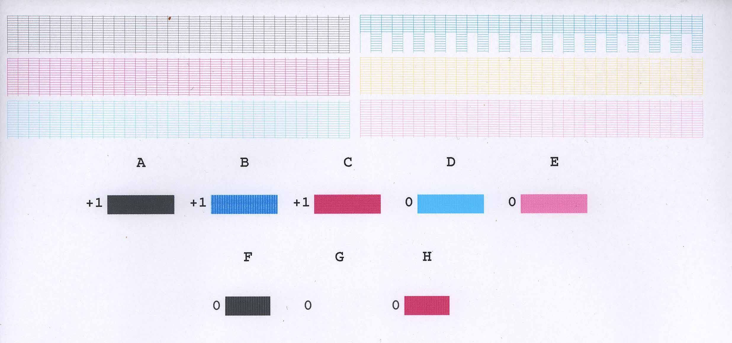

Recently I was not using so often my printer i950 and everything was OK. yesterdai I made a nozzle check and I got this strange pattern:
As you can see the cyan pattern is very strange, moreover nothing is printed in G. What is causing this problem?

Hi, Valerio,
from the print test you showed, I could see the missing pattern is very regular which points to a electrical problem rather than a normal head clog. Most likely is where the print head in contact with the printer did not make good contact. Try take out the print head and wipe the circuit board with a soft cloth soaked with alcohol gently and replace the print head see the missing nozzles come back. Takes only 5 minutes but that's the first thing I would try.
Hope that solves your problem. Do not touch those little springs on the printer, just clean the little copper dots at the back of the print head.

This post shows why problems with exactly 1/2 of a single bank of nozzles (which is what your top right nozzle check shows) are probably caused by an electrical problem, not a clog - like Itsang pointed out.
Please respond with the results of cleaning the contacts.

only today I was able to clean the contacts of the circuit board with alcohol. Unfortunately no success, the missing pattern is still there. I'm fearing that I have to replace my printer. Do you have any other suggestion?

After few trialf I was able to remove the cover of the printer. I verified all the interconnections and I didn't find anything wrong.
What it is strange is that after few trials in cleaning the head as a side effect (I don't know why ), I had a severe ink contamination between black and yellow. So eventually I decided to get a new printhead from PrintHeadXpress. Just after 8 days I received the new printhead and, miracle! everything is again perfect. So now I'm still enjoying the print quality of my vintage printer.
