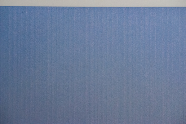

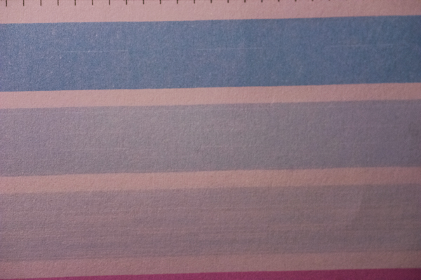

Hi, I've got a picture of the nozzle check. There is no difference between the check before and after the cleaning. It is subtle but on the photographs it looks like every other line is missing.
You can see in the first image that there are very slight lines in the dark cyan but many more in the light cyan. In the photograph (on the right) the sky has this stripe pattern, horizontally printed.

What you need to do is to remove the print head and soak in warm water and washing liquid (Fairy) or similar to a depth of 5 cm for a couple of days.
Then remove it and rinse it with water and leave to thoroughly dry in a warm place for several hours, only then put it back into your printer.
Before you install the cartridges put a couple of drops of Windex (Window cleaner, W5 from Lidl ) then put in the cartridges and run one deep clean followed by a nozzle check.
If the nozzle check is still poor leave the printer to stand for an hour or so then try a normal head clean and another nozzle check, never be tempted to run any test prints till you get a good nozzle..
