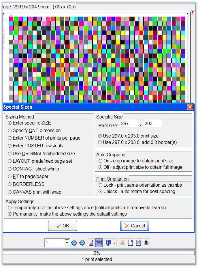

Is there a no nonsense resizing/cutting program for use with TIFF-color charts - that is being sure no profiles are attached.
You know like Adobe Color Printing Utility (ACPU) - where you don't have to sit thinking if you did the right thing - not destroying your charts with unwanted or forgotten profiles..
Saving time and worries that is - just right on - not going through all the necessary settings in PS or LR. In that way also not touching or reresetting your favorite settings in your main photoapps.

Found it - Qimage - if You simplify the interface and you are stubborn.
I have a hate-relation to that program. Every time when I wanted use it, that program wanted to "auto crop" all my pics, whatever I did. Wherever I searched for that d.mned setting - I did not find it. So that program was far down on my list. It is still because of that.
But by googling I found other fellows that also had pulled their hair in the same desperation.
Now, it's a god "printing-help"-prog for my other printer apps - with, as they say some wonderful resizing functions etc that I do not need.
But as for a printing aid - its a fine program -especially for printing calibration charts. The profile handling is clear and easy to understand.

Qimage - you are right - that software needs some adjusting to it. Autocropping on/off is an option in the size option window
