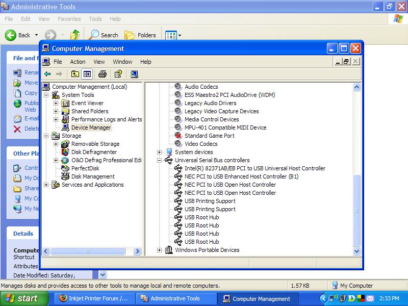

Your motherboard specs will tell you whether or not USB 2.0 is supported.
I have a Canon A620 camera, and when it is connected to a USB 1.1 port, it will tell me. Perhaps you have something similar ?
In Device Manager, under USB Controllers you will see the term "Enhanced" if you have USB 2.0

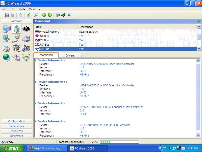

PC Wizard (free D/L) will also identify your controller types.
http://www.cpuid.com/pcwizard.php

This PC that the MP530 is connected to is an old Frankenstein machine. After looking in the device manager, besides the Adaptec card it only shows a "VIA rev5 or later Controller". As was mentioned by Fotofreek, the printer responds immediately to commands to print, even over my network, so I am happy.
Just for the record, in a Belarc report of the PC, and in the device manager, it shows the Adaptec card as having an NEC chip.
