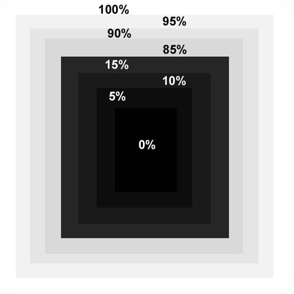

This link gives an image that I use to check the B&W calibration of a display or printer: (http://www.nifty-stuff.com/img/files/B_WMonitorCal.jpg). The center is "pure" black (R=G=B=0), and the values increase in 5% increments for each box. If you can't see the difference between 0 and 5% or 95 and 100%, your monitor isn't calibrated correctly. Print this image to see if the center is darker than the photos printed for your client. If the 0 and 5% print at the same darkness, you may be limited by the inks, the printer, the profile, or the "intensity" setting. If you are using color management, the blacks can also be affected by the "Rendering Intent" and whether "Black point compensation" is turned on. If you are printing through a program like "Windows Photo Printing Wizard" you don't have access to these settings. Try increasing the "Intensity" setting, but don't be surprised if the black turns to a cloudy gray if it is laid down too heavy.
