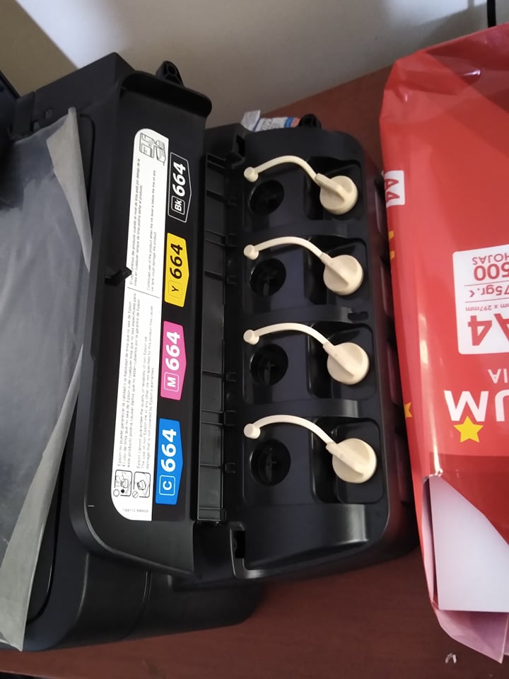

Hi, you're friend Omar here. As I've mentioned in other post I've a Small Stickers Business.
I would like your recomendation on a pigment ink based A3 printer. I've a budget of $600.
I live in Perú, South America. The printer doesn't need to be the latest model. Just one that can get the job done.
As I understand, there are 2 (only?) types of printers ink jet or ecosolvent.
And inside Ink Jet printers, there are printers that use dye ink and the ones that use pigment based.

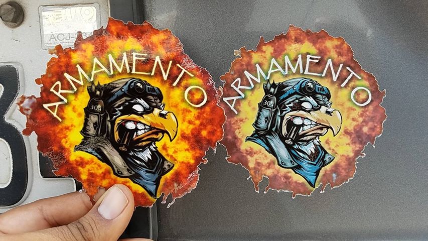

Currently I've an EPSON L475 that uses dye inks. The problems that I need to solve are:
1) Fading: The stickers I make don't last much on direct sunlight (2 weeks).
2) Waterproof: Even laminated the stickers get blurry borders on contact with water.
3) A3 Paper size: currently I can only print up to A4 size.
I'm thinking of having a dedicated pigment ink printer for the business and leave my Epson L475 for other documents printing.
I've also receive the suggestion to use 106 inks for my Epson machine to have a more UV resistant stickers, but since they are also dye inks, I'm guessing the printings will not be waterproof. This is why I'm thinking on a dedicated pigment ink printer.

We should become clear about the requirements of 'waterproof' , that can be about everything between high humidity resistance to underwater paints for ships. Dye inks are water soluble but that does not imply that dry ink dissolves again in water. It is always a combination of the ink and the coating , if you think ink is running off some print it is most likely the upper layer of the coating carrying away the inks. Some companies are selling papers for water proof printing, o.k. - take it with caution but there are wide differences between regular papers how they react e.g. against splashing drops. Or you can get an effect that water would not wash away a print but softens the surface reducing scratch resistance. It all would require some testing on your side . Pigment inks are somewhat 'water' resistant in combination with the base carrier and the coating, but again - do some testing if they meet your requirements.
Dye inks and pigment inks as they are used in the typical desktop printers all are water based with some additional glycoles as a solvent. That's completely different to solvent inks or eco-solvent inks and more complex. You may use base material which is not inkjet coated, you leave the job to the solvent to provide the adherance of the pigments to the base material, there are different types of solvent inks depending on the type of curing the ink - e.g. by heat or UV radiation. Some solvent inks can be used on some Epson printers without modification - you find lots of such offers e.g. on Alibaba, or you need to replace some internal hardware like the tubing or the cartridges since they cannot withstand the solvent, or you need another printhead since there is some rubber gasket inside which does not survive solvent inks.

all dye inks will fade - it is just a relaive matter - which ink is lasting longer than another - and the 106 ink is one of the best dye inks you can get, they'll last longer than the 664 ink you apparently use at this time. You can remove the top of the 106 bottles with some force and fill the ink into the 664 bottles for refill.
You need to search for 'waterproof inkjet labels' in your country or 'waterproof vinyl stickers' or similar. There are as well stickers for backside printing with a carrier foil for the glue. As long as the glue of the sticker itself will not sustain longer periods in humidity or water no ink whatever will survive that.
