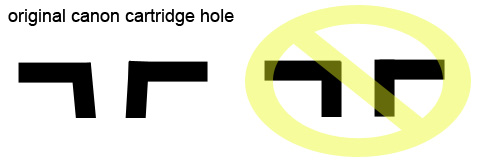

this is my experience with seal plug to seal the default hole on canon original cartridge
The plug (c) sometime can seal into the default hole, sometime cannot. So it's kind of a hit or missed cases. Hence out of all the above-mentioned seal plugs that I managed to try out, personally, I prefer the seal plug (e) as it fits well without any modification and has less hit or missed cases since the default canon cartridge hole looks like
Note that the Printhead carriage will raise up during dvd/cd printing and when one open the printer case cover where the printhead carriage will move to the center. So it's preferabbly to get the plug that seal flat.
In my early days of refilling and where online purchase is almost not prevalent yet , these plug are very hard to acquire so I also use hot glue to seal the small hole created by heating with the paper clip. This is better than drilling the hole as that will cause plastic shavings to fell into the cartridges which can makes one mistaken them as glop later when the ink cartridges get empty. However flushing the cartridges will remove these plastic shavings. Canon tries to make CISS more difficult for those who DIY CISS using original canon cartridges by lowering the corner plastic case.
Should you use the hot glue, just remember to try to keep the hot glue flat (or reduce the height) so that the harden glue does not cause movement obstruction to the case plastic.
Other alternatives is using o-ring screw (but try to find one that does not react with the ink such that it has a tendency to be corrosive/rust the screws).
Here is a thread with replies by others on sealing of the canon original cartrides. Somewhere in this thread is a picture of a blue plug from computer friends mention by Neil's website that was said to seal well.
http://www.nifty-stuff.com/forum/viewtopic.php?id=28
By using hot glue, you don't have to go all the trouble to find seal plugs.
