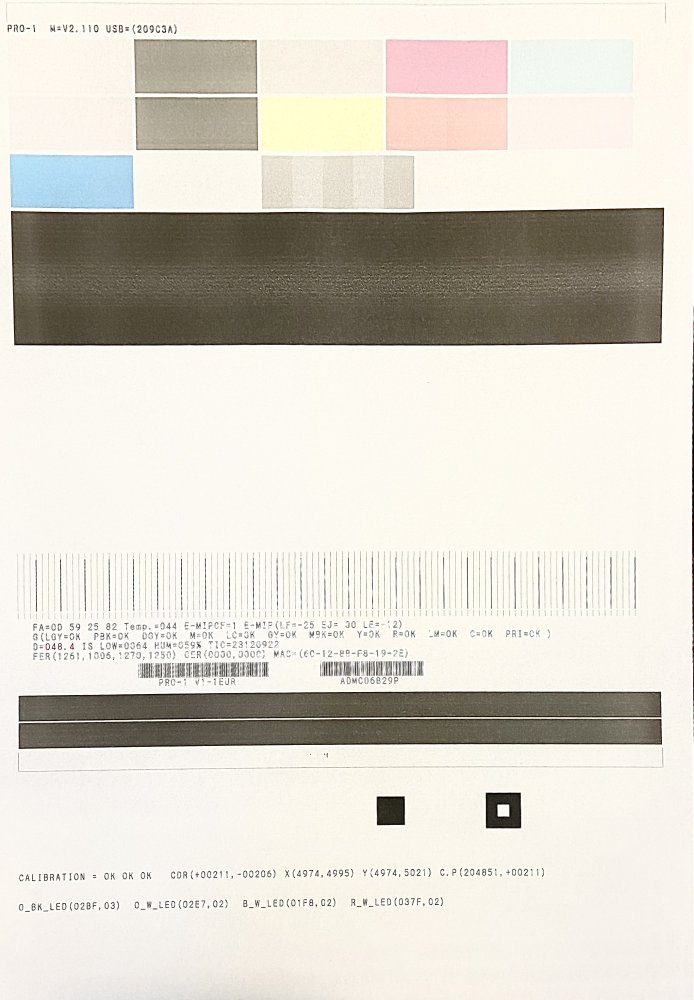

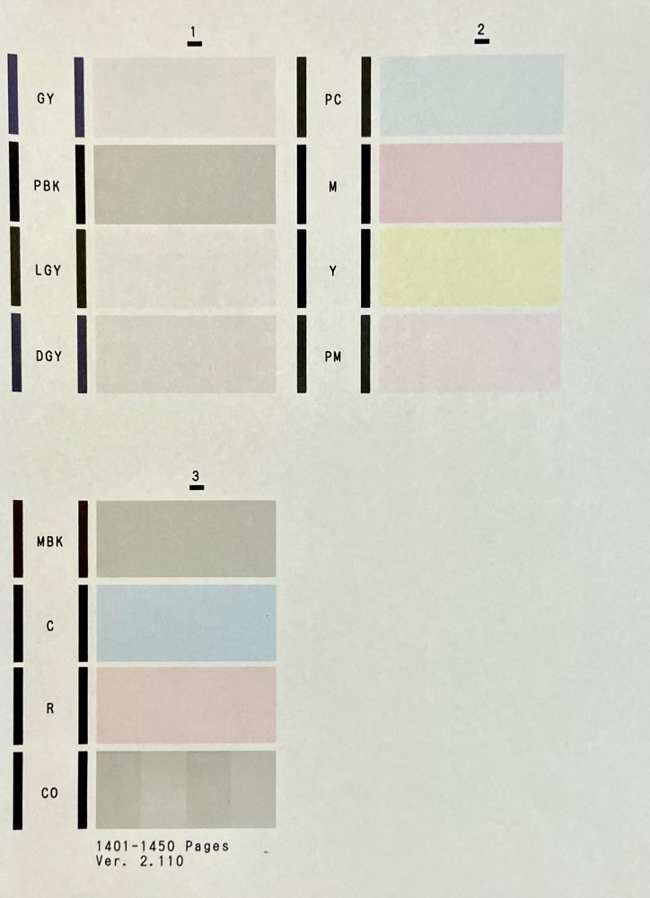

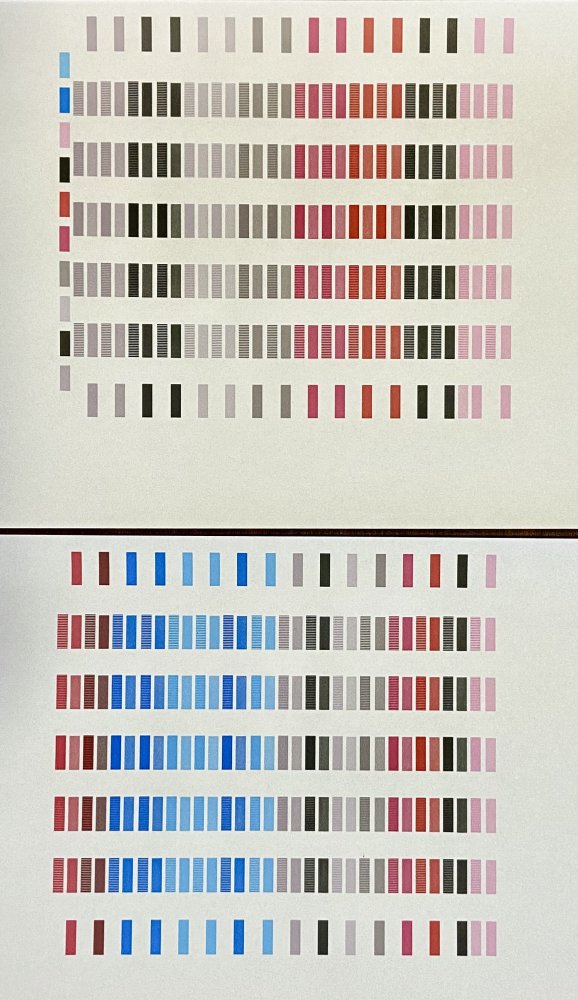

Hi James,
as written at the beginning of my initial post, I'd started by performing a nozzle check as well as a Head Alignment test which both provided perfect results.
I then succeeded to put the machine in Service Mode and to communicate using the Canon Service Tool V3400.
The resulting attached test print also doesn't demonstrate any issues.
Therefore, I'd better suspect something related to paper movement than a Print Head issue.
But if anybody has ideas about any further troubleshooting steps ...

Not sure if the CO channel is supposed to look that way (or the rest of the nozzle check) however the black swatch being okay in the nozzle check but having lines in the printout (and from what it looks to be the larger color swatch in the final test print?) seems to suggest an ink flow issue to me.
You may have several things going on that could give you that output your experience, the good thing is your print head is ok to start with, you could try cleaning the timing stripe that runs behind the back of the print head. (Not easy of this model)
Secondly one of the grey inks may also be having an issue, where some of the pigment could have lodged somewhere in the system, it will clean up with more use but I’d try using a better ink when that tank becomes empty..
You can try running 6 or 7 more of the north lights monochrome image and see if that helps clear the channel, the more use the better..
You asked about the CO printout in your nozzle check.. That is normal, because it has to use a colour background so you can see it is working properly..
Now I don’t know why your using Service mode, but I’d strongly suggest you don’t ever use it again, you may have been lucky this time but the printer can react very strongly to it and lock you out of all operations and there’re no come back from that..
