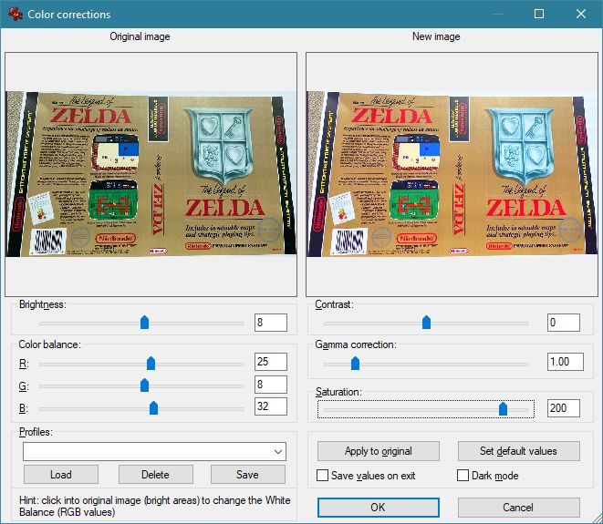

Another possibility is to use Irfan View to change a copy of the image to something that will print correctly. Sadly Irfan View only works with RGB values for colour correction so you get no CMYK values to use for correction, but first try to correct the printed colours to match the original:
Then apply the same corrections to a copy of the original image:
You now have an oversaturated and overcorrected image that hopefully will print as the original. I admit this is not the proper way of doing things but a possible work-around.
