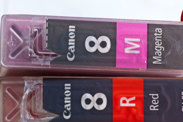

mikling said:
By sealing the air vent over the sponge
This refilling newbie is unclear just what you mean by "air vent over the sponge". Is there a picture or diagram of a CLI-8 cartridge with labels for the different parts so we could have consistency in nomenclature?
It's been a while since I purchased an OEM Canon CLI-8, but my Red and Green were low so I bought one of each (ouch $$$).

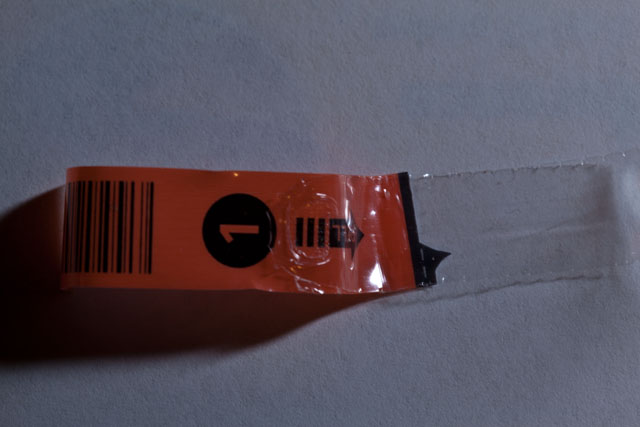

First there was what I think of as the "removable wrapper tape":
Once that tape is pulled off, you can remove the "outer removable wrapping":

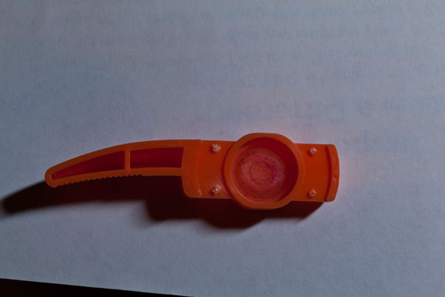

I removed the "Original orange outlet cap" by twisting to break it off:

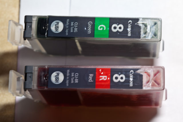

Here are CLI-8G and CLI-8R unwrapped but with original Canon tape along the tape. Is some, most, or all of this supposed to be removed for refilling so the vent holes aren't sealed:
It seems like the original Canon tape is covering up one, several, or all vent holes along the top:
You can sort of make out the "serpentine labyrinth" under the tape above the sponge area. My speculation is that the "air vent over the sponge" on this CLI-8R Red cartridge is just under where the label "Red" is located. Is that correct?
Here's the 8R along with a refilled CLI-8M Magenta that has had the plastic ball pushed down into the reservoir, plugged with a R-Jet Tek #1916, and showing red electrical tape that will be used to cover the #1916 plug. It seems like there might be vent holes under the tape where the "Push" label is, and also below where the tape ends, which looks like concentric circles with a centered dot.
"Inquiring minds want to know". Are there better nomenclature terms for the above? Where are the two (or three+?) vent holes along the top, what are they for, and when are they supposed to be open and closed during refilling, storage, and use in the printer?

The air vent opening is shown in your fifth picture down as the "L" shaped grove on the untaped portion of the cartridges. The air vent includes the serpentine path and the "wells" it encounters on the way to where it finally enters the inside of the sponge chamber. You do not want to remove the tape covering this air path as it is vital to the design of the cartridge.
See this thread for more info about why you don't want to remove the tape covering the serpentine path.
