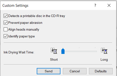

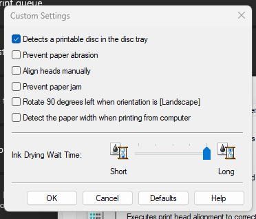

Most likely there is a curl (bow) in the top of your paper, try gently curling the sheet the other way to straighten..
Also use the Custom printer settings to alter the height of the print head…

I appear to be misisng the option of 'identify paper type'

Forget about that option, it’s not needed to solve your problem..
And your purge unit looks pretty clean too..
Sorry for all the questions. Is it normal to lose print quality when using 'prevent paper abrasion'?
The colours seem much different vs normal prints for me

View attachment 15671 I appear to be misisng the option of 'identify paper type'
I think he's talking about 'Prevent paper abrasion.' I assume this is some rudimentary platen gap adjustment?
Your transport riding higher up from the paper would affect how the image is drawn onto the page. I'm sure the driver or firmware has a correction factor for this but it's probably something where your mileage would vary based on a number of variables.
