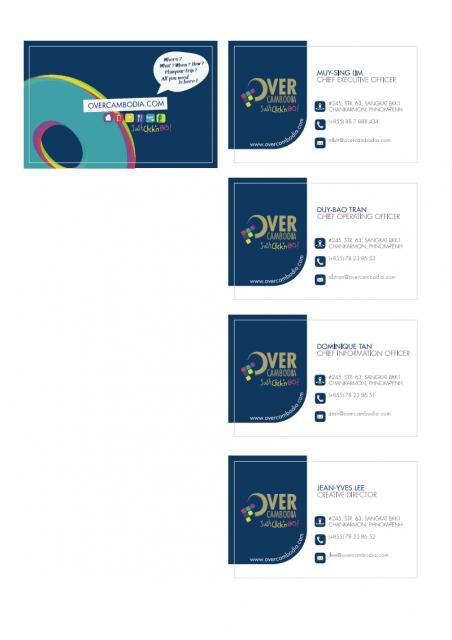

Today I got one printing which I couldn't get the mail color right. On the screens it blueish, but the printout is greenish - others colors are just right.
I then export it to .tiff and .psd files. To my surprise, the .tiff thumbnail file shows the greenish color which matches the print out!!! I open them both in Photoshop to just see that the color of both files are the same blueish.
I have attached the thumbnail viewed in DirectoryOpus, and the actual files in .psd and .tiff and the original .pdf file which I got from the client.
What I can do now is tweaking the color bars from the printer driver adding up more blue and red.

The blue one is what the client wants, but all my 3 printers profiled with ICC all give the green!!!
Is there anyway to convert that to get that blue as I believed the client might not even understand the color - he just knows to design?

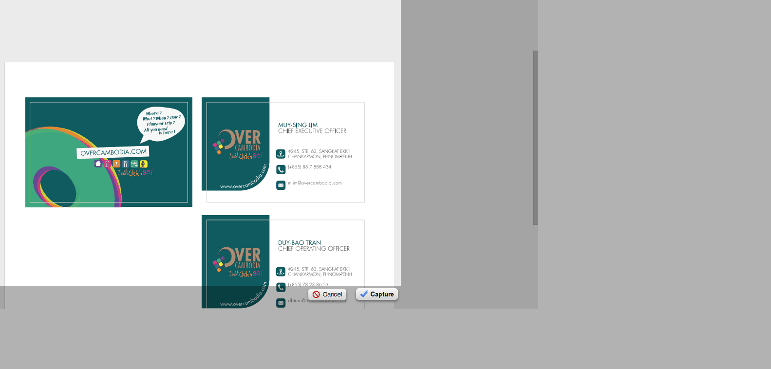

If this what you are looking for more or less?
I opened your three green ones in every tool I have and they all show your UNTAGGED file ( No Embedded Color Space ) as green.
I converted one of your PNG files from their current LINE COLOR MODE to RGB and saved it as a Tiff to be able to shift the hue of the green to blue. Then saves as a JPG to upload here
Otherwise NO! ALL you green files still look green no matter what I view it in.
I did not see the slight shift toward blue you show on you 4th side by side comparison.

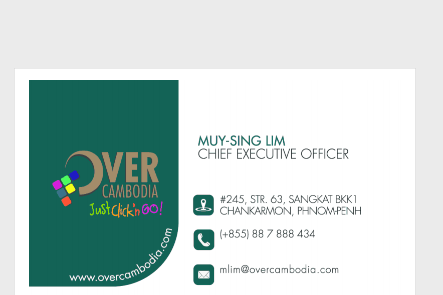

Here is the intended blue color, I captured from .pdf file above:
Can you show the green you see, please?
Here is the green i have captured from .psd file above:
Also note that this .psd file was exported from .pdf ile in Illustrator.

The difference as I see it is so minute to be almost a non issue.
To me it still looks as an actual green. Just slightly bluer but still green.

I used ColorZilla to get the color from the 2 pics above:
blue: #0F5B5F
green: #136356
Blue is what the client want because it shows this on screen and also he brought me his print sample - it's blue like that, but all I can print is green which you also get.
