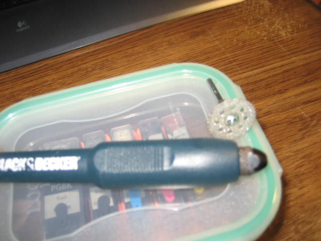

the cutting wheel i used was bought at the local home depot for $3.00 it is called a diamond wheel and it was attached to a pencil like attachment for my black and decker dremel type tool, the cutting wheel didn't so much cut the plastic as it melted the plastic so when the slot pieces were removed there was a lot of plastic attached to the bottom side of the case that you can pull off now for the procedure

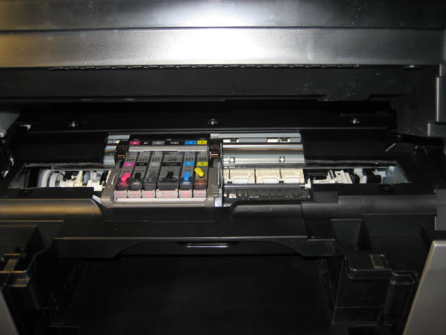

first with the printer on lift the cover so the printhead is centered, unplug the power cord this allows you to move the printhead carriage from side to side
i placed refilled carts with plugs in the printhead so i could see how wide the slot would have to be

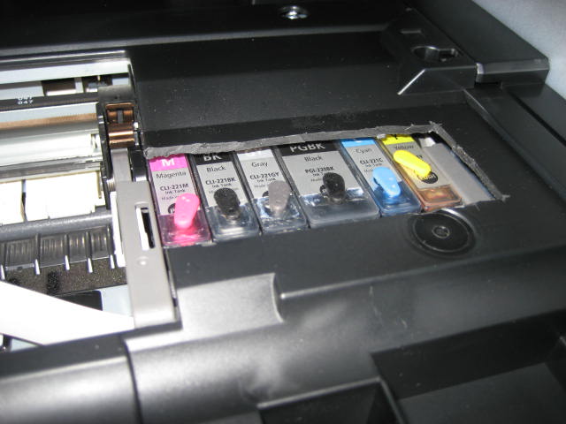

i first cut the left side as there is less chance to do "damage" on that side and there is a little more clearance for your tool
move the printhead carriage all the way to the right after you remove the printhead
take a small piece of cotton cloth and stuff it under the left side of the cover, try to keep it a single layer of cloth so it will sit below the cover and the cutting wheel will not grab it, when the cloth is in place it should be long enough that the remainder of the cloth will stick out of the middle opening and cover the right side of the cover so no debris gets in the right side

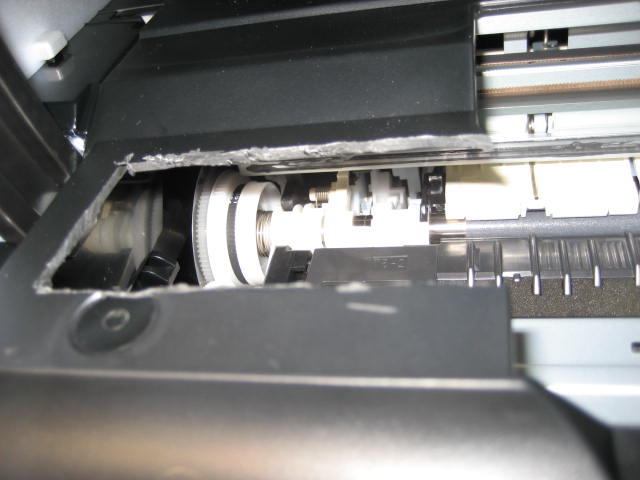

slide the printhead carriage to the left side repeat for the right side

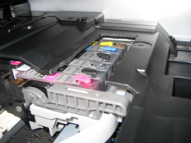

put your cloth in place and follow the masking tape that you marked the top of the cover with again be aware of the white ribbon
the right side is a little tighter to work with the dremel tool
the cutting wheel i used is 7/8" in diameter or 22mm
the slot on the left side is 1 1/2" by 3 1/4" or 38mm by 82mm
the slot on the right side is 1 1/2" by 3 1/2" or 38mm by 89mm

the slot on the right was made a little longer to insure all cartridges cleared the case when parked
