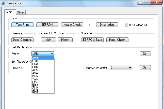

Today I discovered that Canon printers are region locked - searching around suggests that there's no way to alter the region of my printer to match the local market for ink cartridges, so I need to work the other way around: does anyone know of any reset tools that alter the cartridge region?
Specifically, I want to be able to set CLI-221 and PGI-220 tanks to European region. Any suggestions?

Why go to all that trouble changing your printer when you can easily change the chips instead.
You can use any region cartridges from any part of the world by
simply changing that chip for one in your own region, it couldnt be easier.. :)
