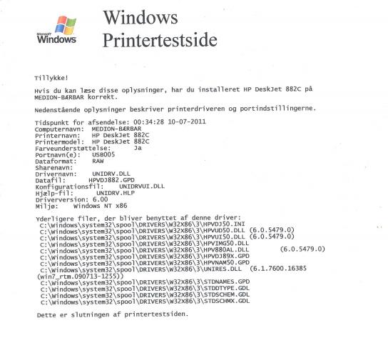

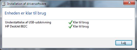

I have a Deskjet 880 C, which I think is very similar to the 895 Cse. I have a laptop with a Core 2 duo CPU running Windows 7. Installation of the printer is as simple as it can be : Just connect the printer to the computer and Windows finds the driver on the web and installs the printer in less than a minute. This is how it should look, when installation is finished, but of course in your language instead of Danish: http://www.nifty-stuff.com/forum/uploads/6881_hp880c.jpg

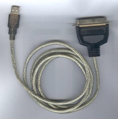

A wild guess: The printer is connected to the Compaq with a parallel cable, and the Dell computer has no parallel port, so you will have to use the USB port on the printer. If the Dell computer doesn't see the printer when it is connected to the USB port on the printer, it could mean that the USB port on the printer is defective or maybe the printer has no USB port ? In that case a USB to parallel converter cable could be the solution. like this: http://www.nifty-stuff.com/forum/uploads/6881_usb_to_parallel.jpg . The converter cable is also installed automatically under Windows 7. I installed the DJ 880C twice using first a USB cable and second using the converter cable. Both installations work perfectly : http://www.nifty-stuff.com/forum/uploads/6881_hp880c-test.jpg

i upgraded to a new dell that only offers USB. as was suggested by Peter, you need a USB to parallel cable to get it to work.
i just plugged it in and it found/installed the correct driver. was printing in under 5 min
