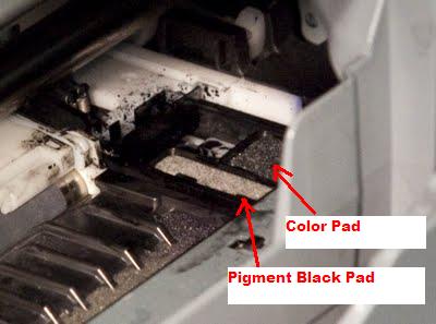

Thank you for the reference to the #19 photos. Unfortunately, I still don't really know or understand where that is? I can't seem to locate those on my Canon MP830. Please advise how to find those.

I added text labels on the photos.

mikeasmel said:
I have the same problem with my Canon MP830...my PGBK doesn't work though it is half filled. Where exactly is the print pad that I am supposed to flood with Windex and what does it look like? I have taken out the print cartridges as well as the black plastic unit that holds all 5 cartridges, however I don't understand where I am supposed to put Windex? Please advise and/or post photos and specific locations. Thanks much!
You don't need to, nor should you, remove the cartridges or print head (the black plastic unit) to access the purge pads (not print pads). When you open the printer cover, the print head will move to the center of the printer so that you can gain access to the purge pads. The photos that embguy editted show clearly where the pads are located but they may be very difficult to see on your printer. But once you know what to look for, I'm sure you be able to identify them.

Did you try what pourhaus did in post #19? He removed the pigment black purge pad and cleaned it and the rubber tray it fits in and put it back and then did some cleanings and that fixed his problem.
I tried this on another MP780 belonging to a friend of mine and it fixed his printer too.
Another thing I did was put a syringe on the small opening the tube connects to and suck on it. I don't know if this made any difference but you might want to try this too. On my printer, there are two of these holes but one of them is very hard to get to without taking the cover off the printer.
I'm thinking that what appears to be a purge pump clog may really be simply a clogged purge pad and I think on the other printers I was trying to fix by simply putting lots of Windex on the pad, I ended up forcing the clog down the purge tubing and making it worse.
Note when you remove the pad how it is placed in the rubber tray it sits in so you can get it back in the same way. You will see that one corner is cut off. This corner goes in the far right position.

Let me summarize the purge unit unclogging procedure.
1. Take out the purge pads. Clean the purge pad holder inlet port(s). Do the purge unit test again by flooding the pads with Windex or water.
2. May need to suck the clog out by using a syringe if clog persists.
3. Time to open the printer and visually inspect the purge unit tubing.
