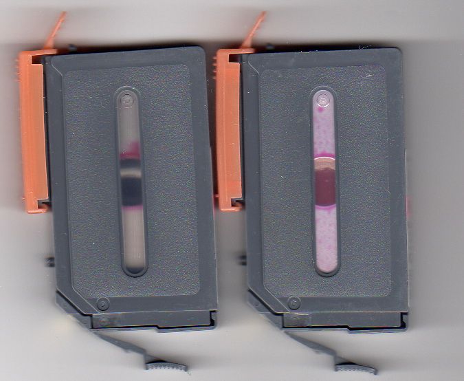

OK I will illustrate what is happening here.
Here is a scan of two cartridges both are PhotoMagenta. One is empty and one is full.
The cartridge on the left is empty and you should be able to see the diaphragm sink into the inside towards the opposite side of the window, That is what happens when the ink is used up. The accordion like bellows flatten. The cartridge on the right is full and the bellows are fully extended and lie close to the window.
Thus when ink is used up, the flat diaphragm heads towards the other side of the cartridge. Air does not go back into the bladder. It enters the case outside of the bladder. The seal on the underside does not allow air into the cartridge at all. There is no air intake to the inside of the bladder.
Maybe after a few times of speed refilling you should refill slowly just to disperse any possible issues.
